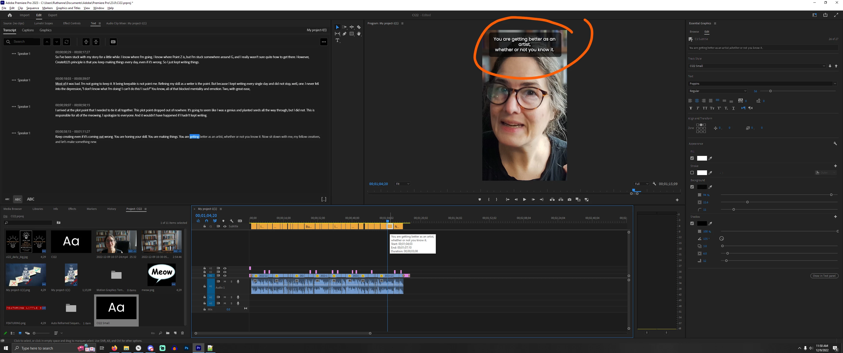

My challenge is the placing of the auto word-wrap makes no sense. It does those single-word breaks in the middle of a line, when there is no split in the captions themselves.
I've included a screenshot to show you what I mean. Why is "fellow" on a line all by itself?
So we have no idea why it chooses completely random words to split on?

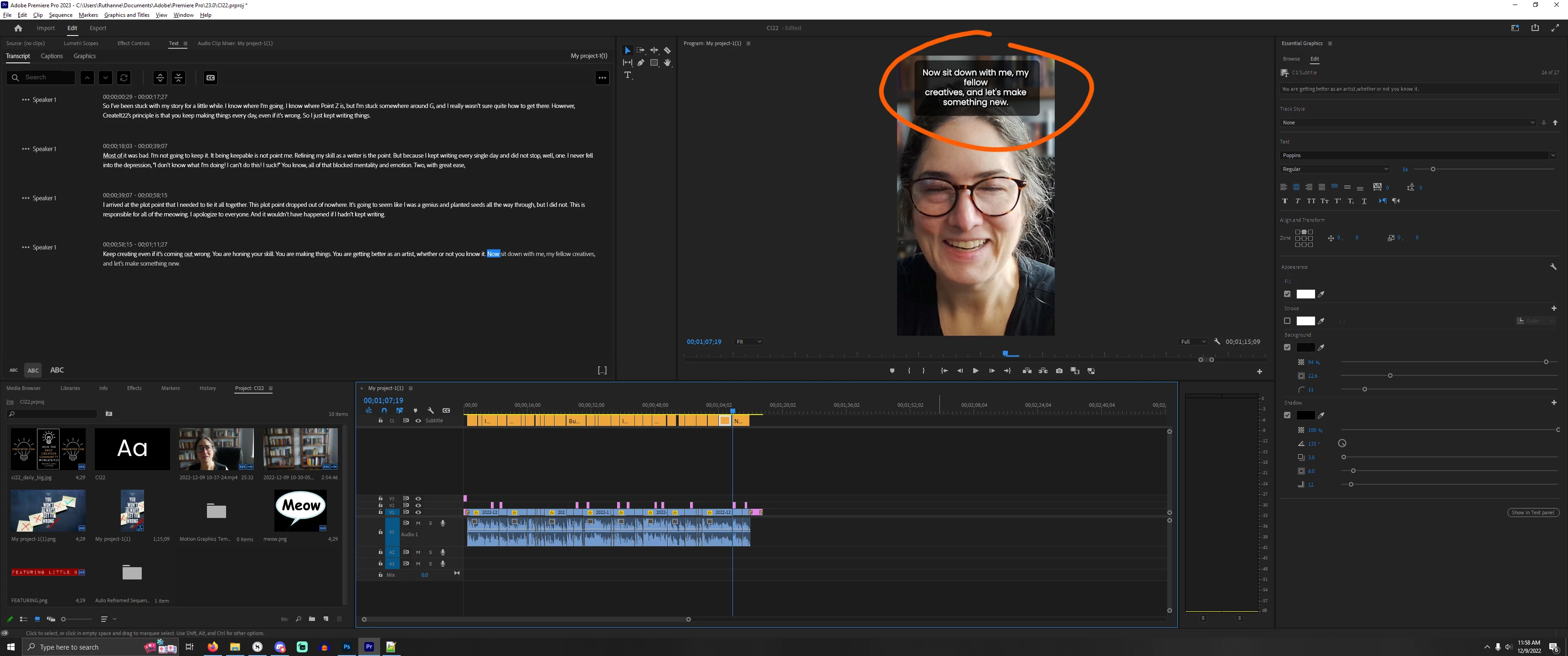

One more image so you can see that this weird one-word thing has nothign to do with punctuation or word-size.
