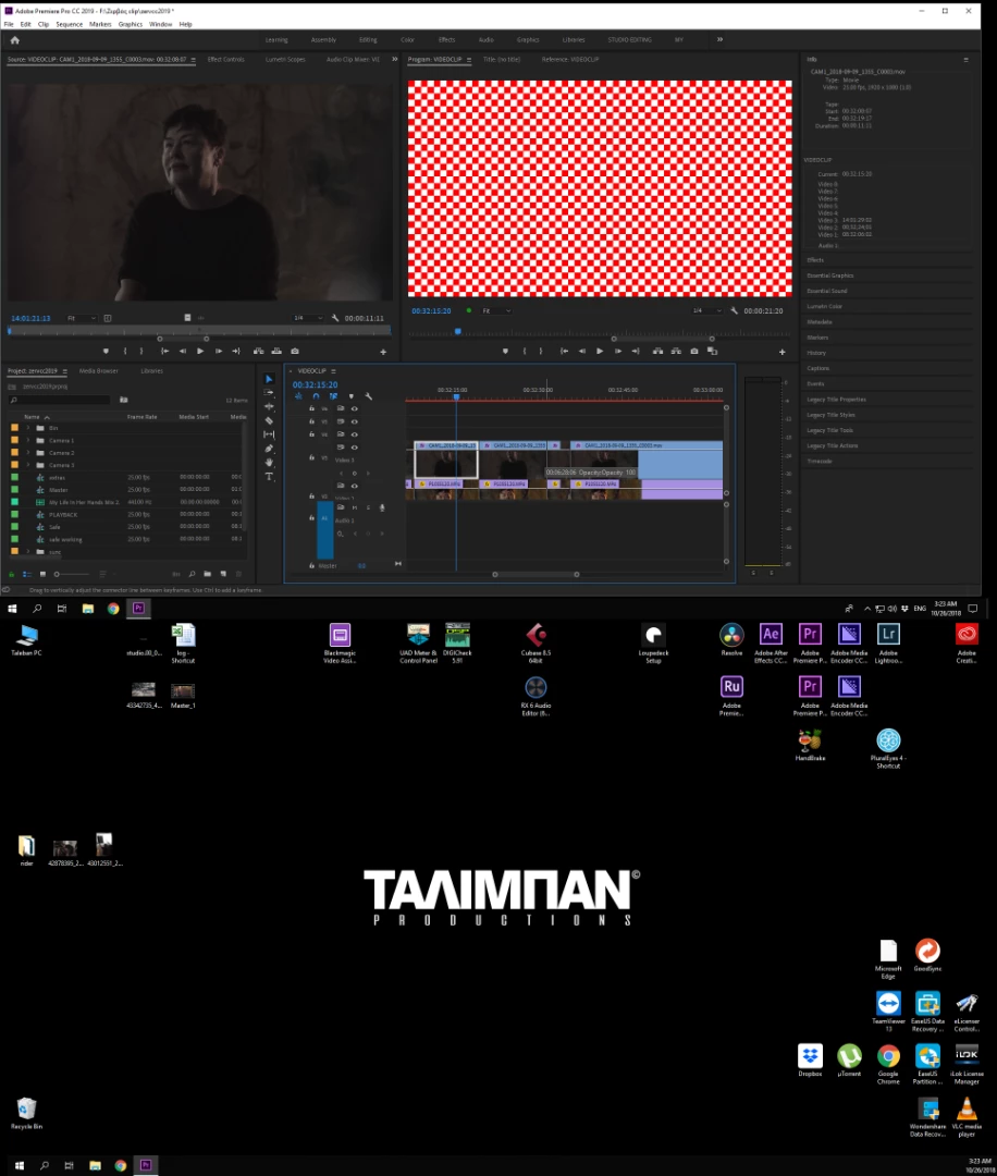

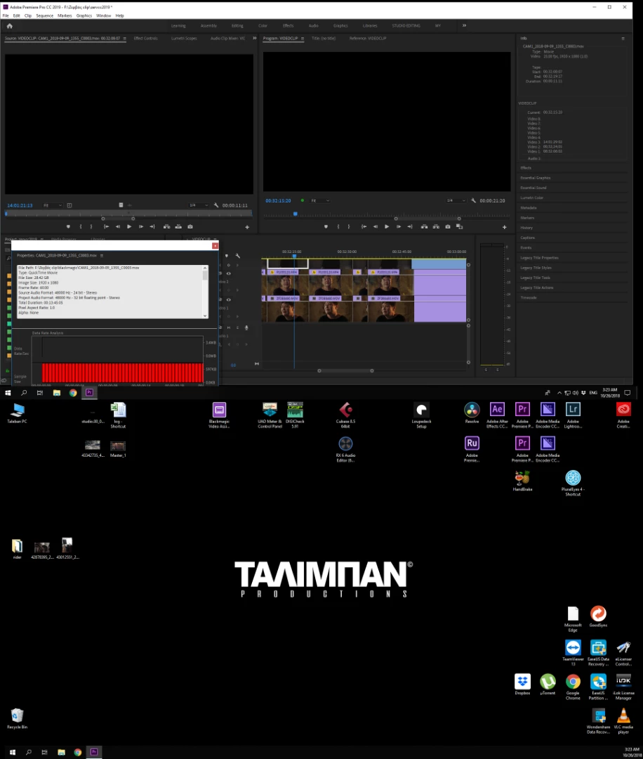

Hello, In the latest i update i have bizzare and really troubling issue. On a project I was working on cc2018, that has h264 and prores files, when I try to playback the prores files, the program screen comes black and then nothing else plays. Even other projects woth h264 files until I reboot premiere. It seems to have an issue with the Nvidia 1070ti (latest drivers) and Prores. I m on a pc i7, 32gb Ram, Windows 10 64bits
I see that it happens and cc2018 also, and the source screen plays the some files, some dont, but nothing on the program screen before everything come to black!
When I switch to Software encoder I get a red and white mosaic pattern in the program monitor where Prores footage should be!

I am on Windows 10, not OS so this article wasnt really helpfull. I get this super weird screen after the hung up of the CUDA. Black CUDA enabled, this patters on software. No such problem on h264 projects.

So, it shows in previews and the Source monitor but not the Program monitor ... huh.
I noticed the Program monitor is set to 1/4, does it do this at other settings?

Thanos_Liberopoulos
October 25, 2018
Yes I have this latest version, and also tried to roll back to the previous version and still the same. I can't work my current projects all of a sudden so I will send you screenshots in an hour when I will be back at my office to fnd a solution. Thank you
