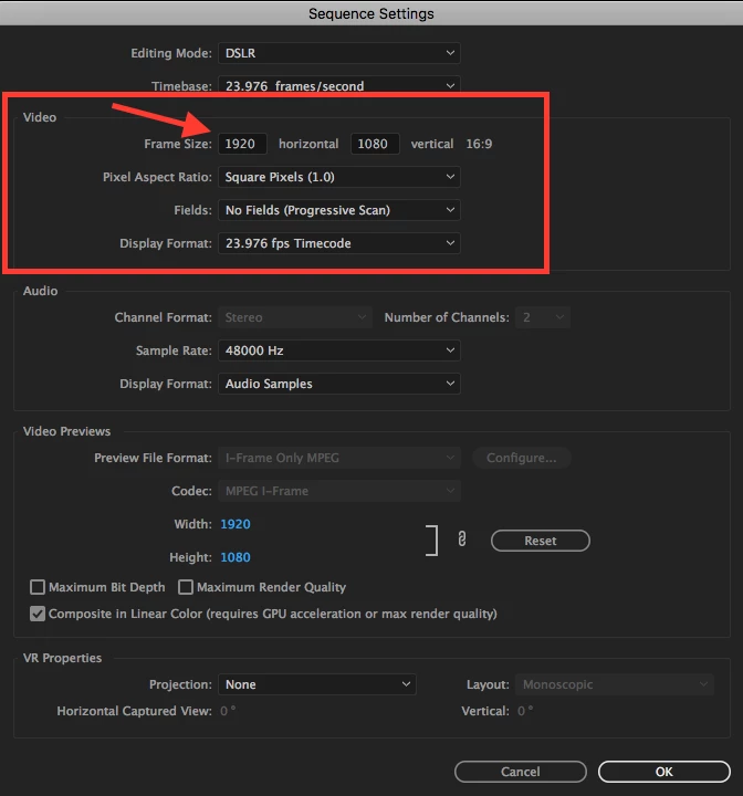

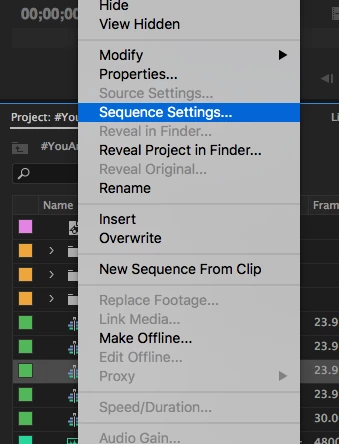

    Hi sinclaira -
    1. Right click on your sequence from the Project Panel and select sequence settings.
    2. From the sequence settings window, under "Video" change your horizontal to 1920, so you will get a 1920 x 1080 pixel resolution and an aspect ratio of 16:9.  Then hit ok.

    Hi sinclaira -

    If the sequence is made of a preset you cannot change height and width without changing the editing mode to Custom first.

    If you want to change the framesize, select sequence in Project Window,
    Go to Sequence / Sequence Settings,
    Set Editing Mode to Custom,
    Change horizontal and vertical parameters.
