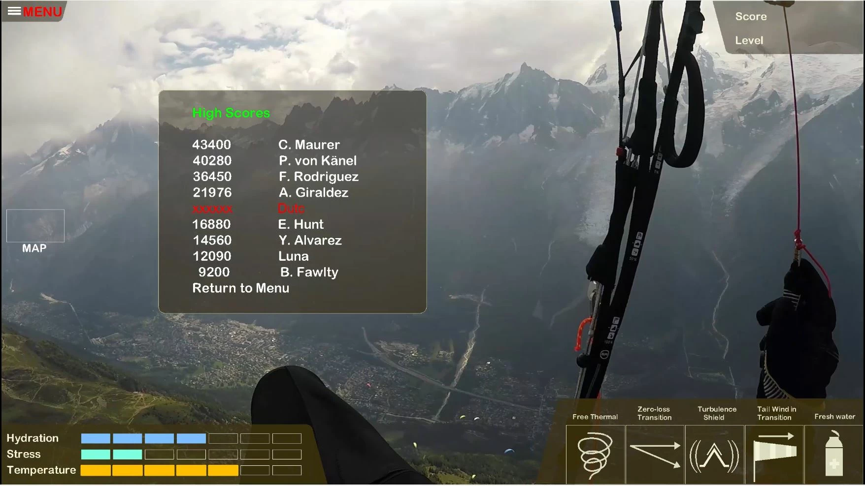

I'm trying to change the opacity of one single color in a layer.
What iI need to get at the end is:
- that all that is black should be 0%
- one other color abt.50/50
- while all the rest to be at 100%
Anyone knows easy trick to do that?

Actually the file where I want to make a part semi-opaque is just a photo, as an overlay on my video.
I just made a PNG where I already can make an alpha-channel. So the part fully-transparent I solved it:-)
But still struggling to make one specific color semi-transparent while all other colors keep opacity at 100%
Already tried something with Luma Key and Chrome Key, but as not being familiar with it for sure doing something wrong 😉
Tonight will try more with those options as you mention 🙂
If I still cannot get it fixed will upload a screenshot of what I want to make.
