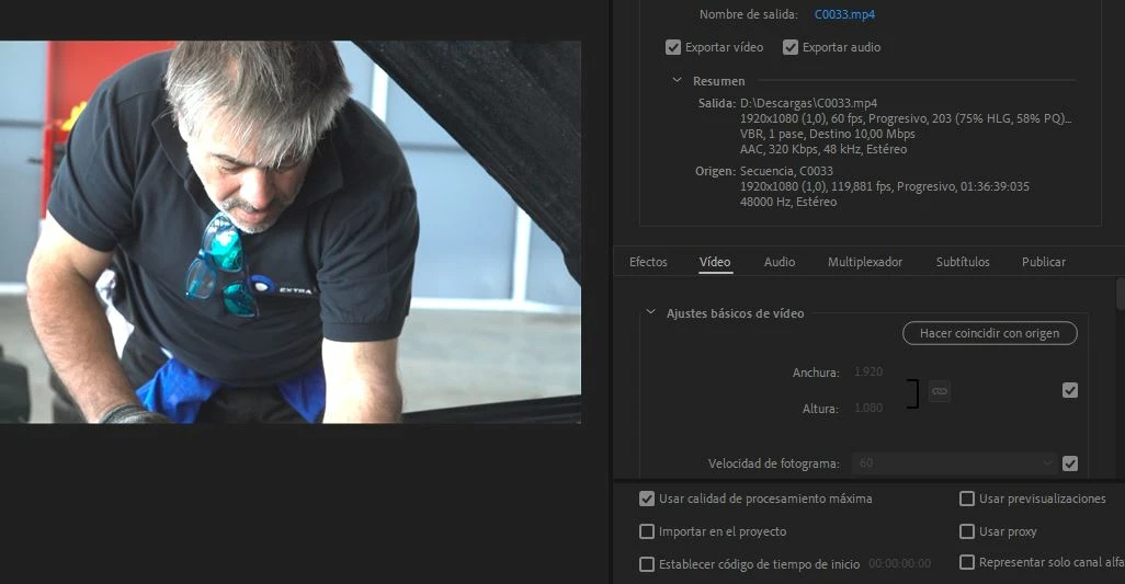

Since I installed Premiere 2022  I edit my videos made with a sony a7III,  while Im editing they look fine, but when I export them Premiere change the colors, saturation and contrast  - as you can see in the atached screenshots, what is happening? what can i do? why such difference between what i see at the timelime and the exported result?

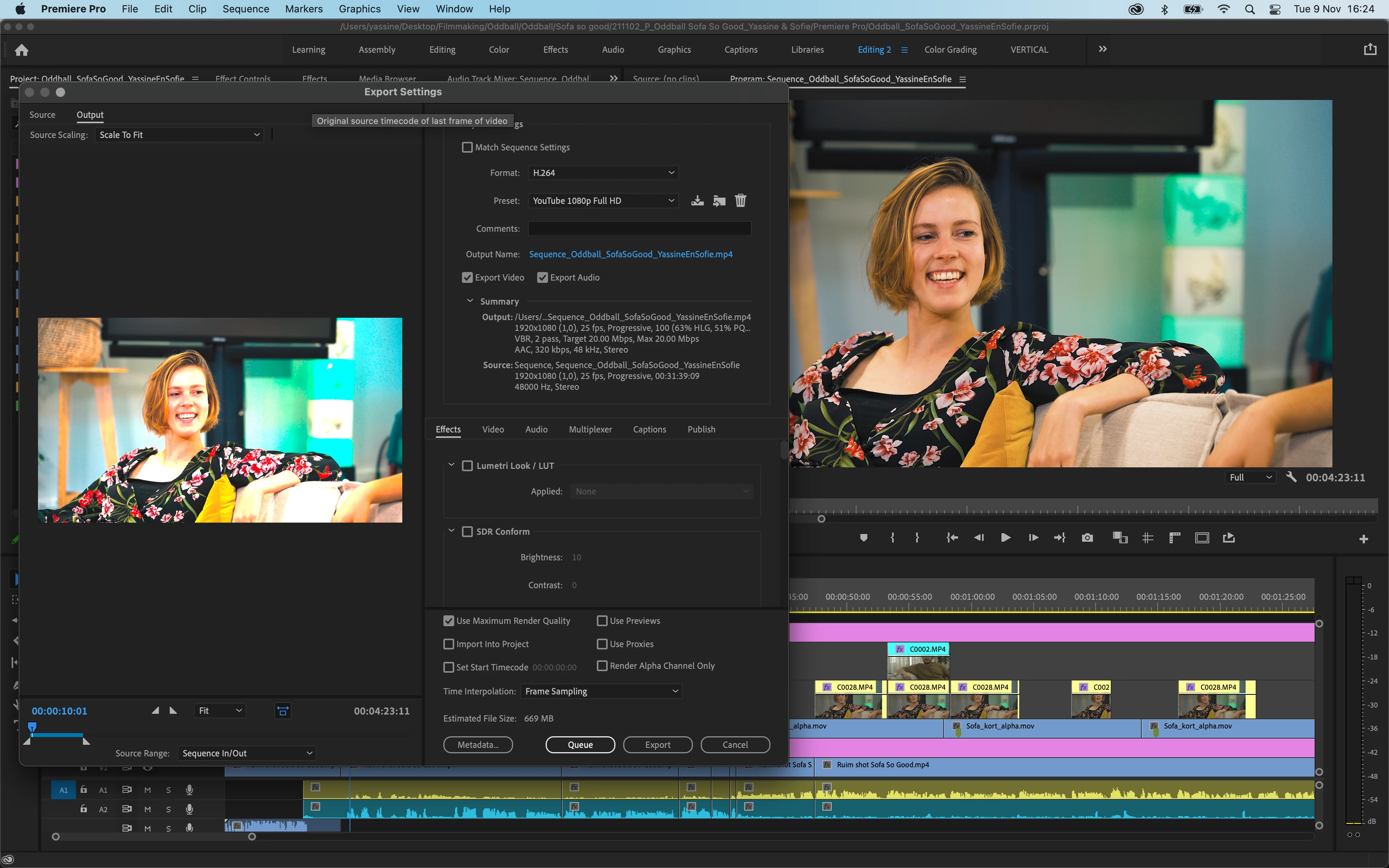

Same here.. new update is throwing off export colors.
Interpret footage to Rec 709 did not work, makes colors look weird too.
The SDR conform option during export was closer... but tonalities are off.
I use a Sony a7r3, can't color correct exports properly at all anymore.
Please help Premiere.. why did this update adjust the way colors are exported!?!?!

As noted all over the forums, they updated CM options in the 2022 version. You do have some color management options for some media in the Project panel, modify/interpret footage. And there are CM option for the Sequence settings dialog also.
But as part of their updated CM practices, they also selected some of the frequently used DSLR/mirror-less cam log styles, and adopted the manufacturer's 'default' setting for normalizing/transform of those files. Without giving the user the option to override that default.
As their chief color scientist has said, all the data is there, just rearranged to be 'properly' normalized according to the manufacturer of each camera. Nothing is clipped or crushed, so the user should have full capability to grade the file to their taste without data loss. As far as they're concerned, they simply saved users a major step.
I would rather always have a user override. As for any log media, I normally roll my own transforms/normalization.
But ... for now, that's what's happening to your media. You can use the Lumetri panel to mod it as you wish.
You could also make a Lumetri mod and either save it as a preset or as a LUT. Then that could be bulk-applied to your media even in a bin before it gets to a timeline.
Saving as a Preset means you would have a full instance of Lumetri with the settings as saved, named/described as you choose, in the Effects/Presets bin. You can select a bin of clips, and drag/drop that onto the clips, and the Lumetri instance would be applied to every clip's "Source" settings, so for any use of that clip any where in the project it will have that preset applied.
You can do specific use-needs mods to Lumetri on the clips in the timeline as normal.
Saving your mod as a LUT means that you can apply that through the Lumetri panel in either the Basic or Creative tab dropdown slots.

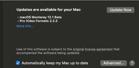

I wonder if this has something to do with the codec updates that Apple has released in their latest update for Monterey... granted I updated to Beta hoping for an update! 🙂
One of my friends who does editing for Netflix has the issue too and his workaround was a LUT for export. According to Adobe its a codec issue with 2020 Mac Pro / Tower computers.  Doesn't seem to affect Windows users to my knowledge.
