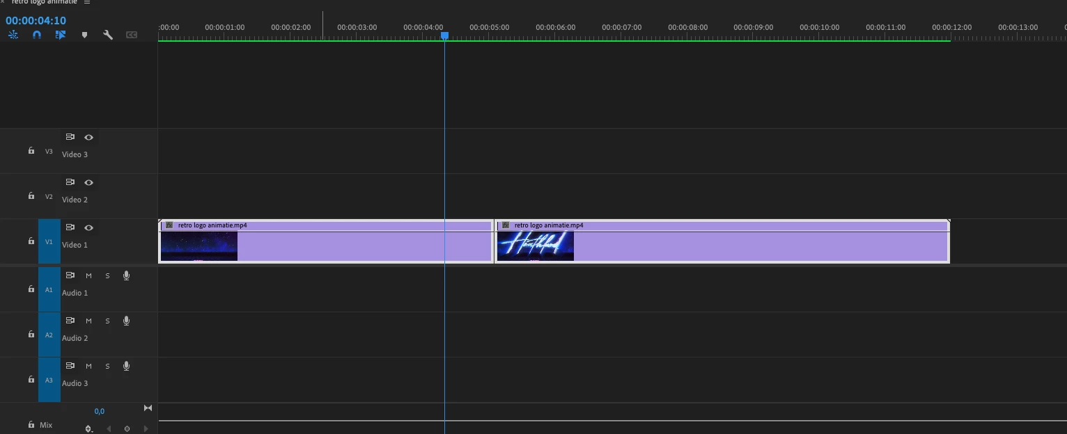

Thank you for your clear awnser Ann. Maybe you can help me out with the following too:)
Picture 1.
lets say i have two clips and i want to apply my default transition between the two.
Picture 2.
i select the two clips and press my short key for the default transition. Now you see there are three transition 'boxes' placed, but i just wanted the one that would connect the two. Is there a fix for this?
