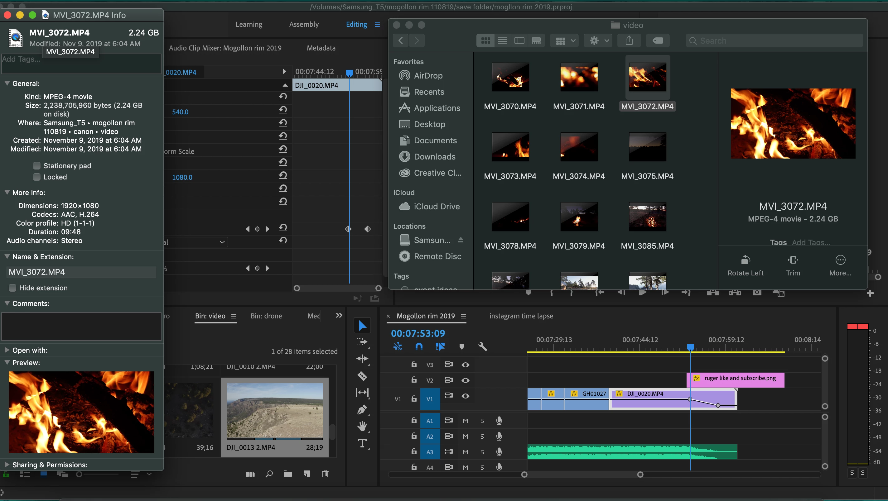

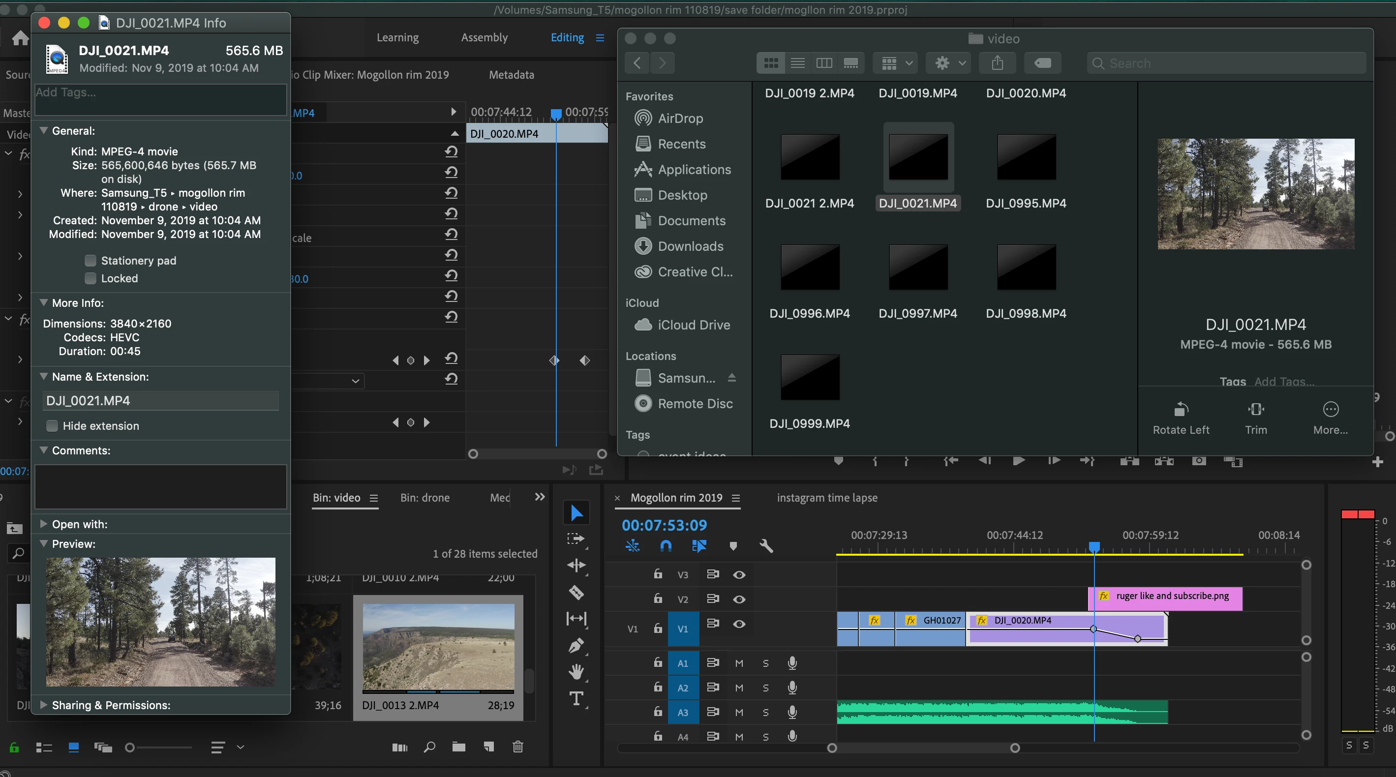

November 20, 2019
Its footage from a drone, go pro and a canon camera.
I'm not sure but here is the info from each type of file thats giving me trouble
Drone mavic 2 pro:
Canon sl3:
