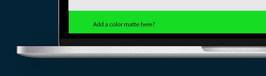

Hi Stan! Finally back. 🙂 Thanks for your dedicated support. Seems like that works better; I can now make the clip smaller and zoom in again, but some quality is still lost. Can I improve it in some way? And how do I merge the clip with the image (the screen) in the best way? By nesting (or will nesting cause issues when zooming in again?). How to fill the screen in the clip (its not 100 % the same size as the screen in the image, see draft below, including extremly misplaced screenshot). These two clips have been nested.

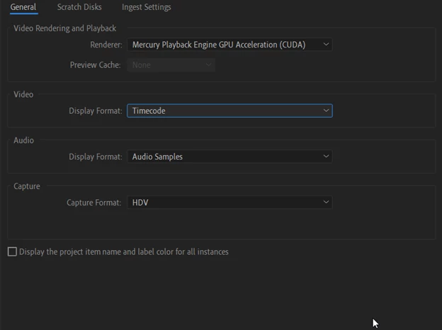

Does it matter what I choose when first setting up the project?
