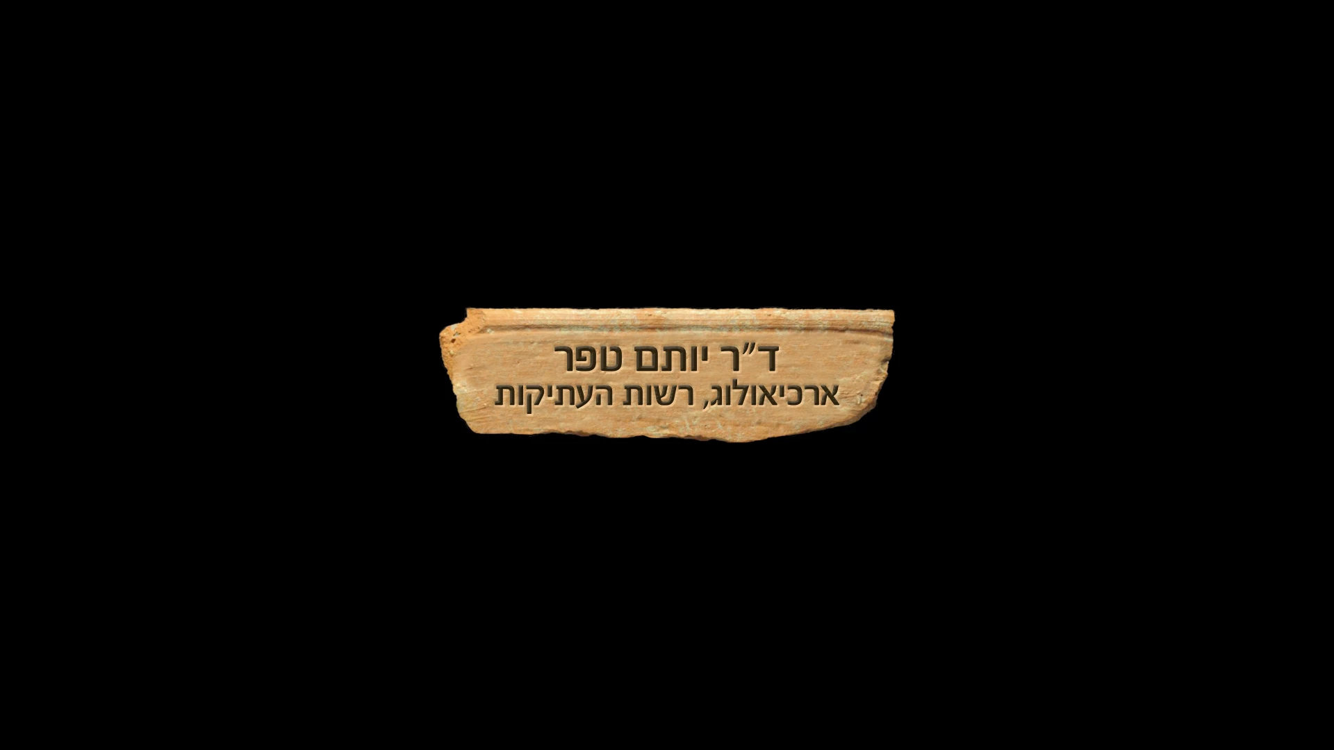

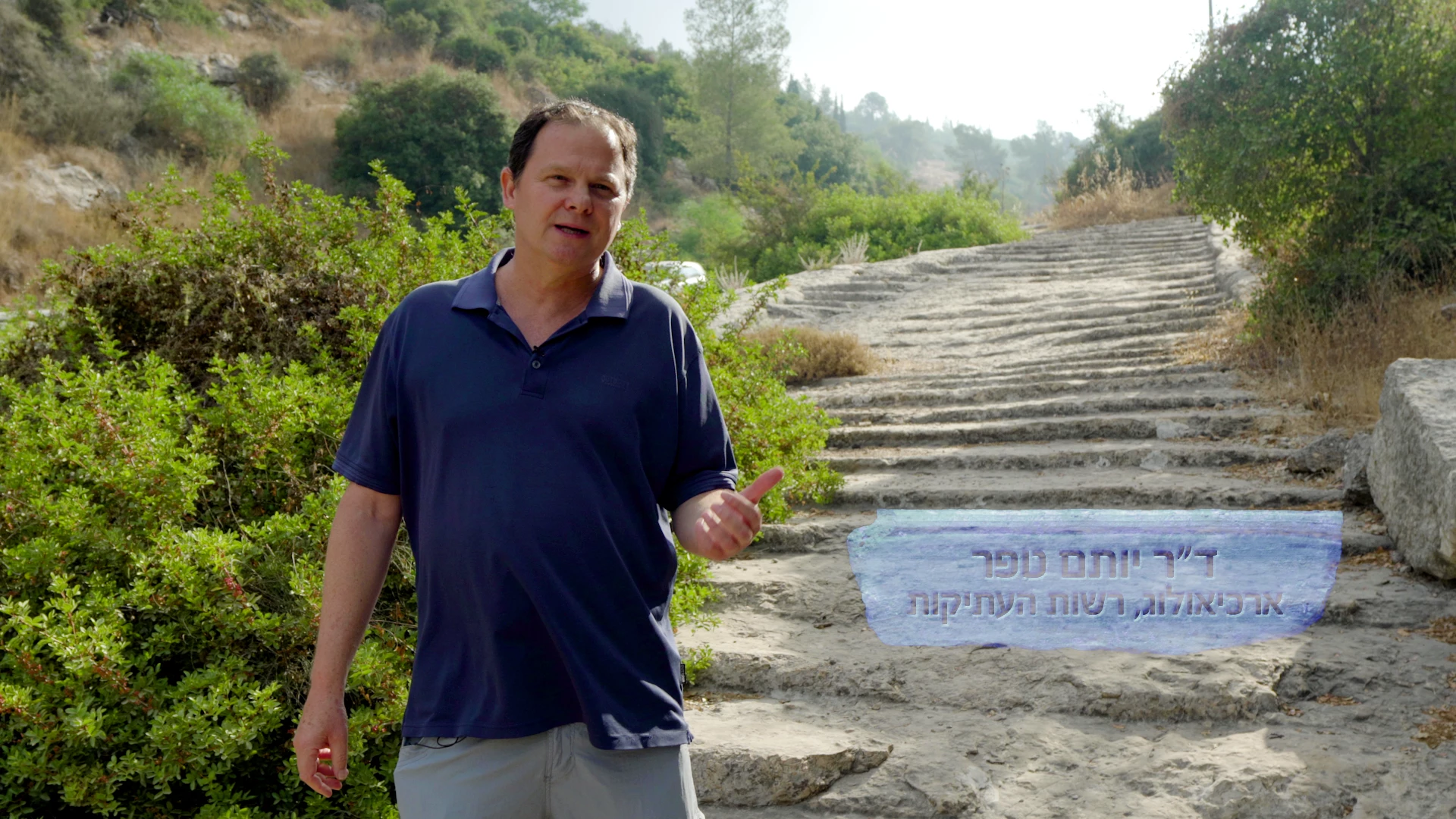

I upgraded my OSX to catalina lately, and ever since I experience a troubling issue with clips that contain alpha channel.
I export the clip from AE with alpha channel, RGB+.
When I import to Premiere is seams that one of the color channels is missing, and the whole apperance is completely wrong.
I tried to export as either Animaion or ProRes 4:4:4
I tried all the possible options of the alpha channel section in the interpret footage dialog.
Nothing helpes so far.
Any suggestions?
Attached are screen shots from AE (the graphics as it should look) and PP (the wrong appearance)

I have no idea what's wrong with your workflow, but as a workaround you can export a separate alpha channel file and composite in premiere.
December 31, 2020
Thank you
The thing is that nothing has changed in my workflow, I work this way for years with no problem.
Your workaround can work, but I edit in Adobe Premiere Pro for the simplicity of workflows...
