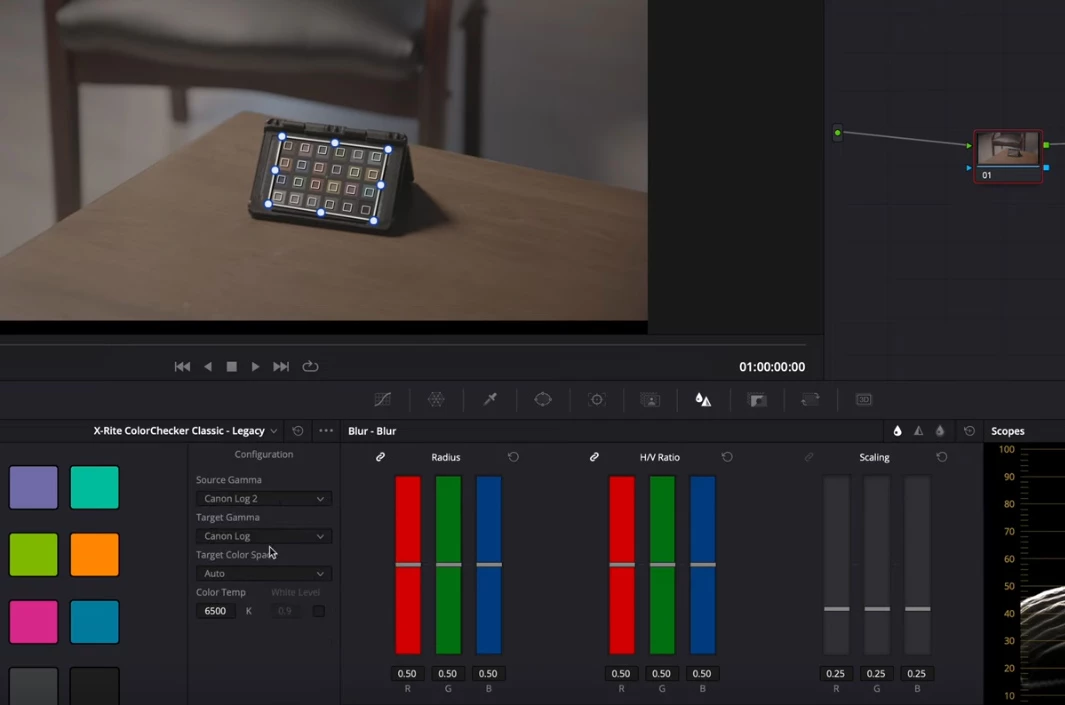

I was watching a video on Davinci Resolve, on how to use the Color Checker for editing. Is there any way we can do the same with the Premiere Pro?
I am attaching the Screenshot.
Thank you very much.

Not automatically though as an experienced Resolve user, I don't see consistency in Resolve using their auto-systesm with the Xrite cards either. Sometimes pretty good, but not really consistent results.
So in both, I manually set tonal/hue responses, then batch that Lumetri (or color page 'still' in Resolve) on the other same-camera clips in the bin.
First, set the set the white, gray, and black patches to both zero neutral and to the value level that you will want across all cameras. This makes your WB and tonal values consistent, absolutely necessary. And no, "I did a custom WB in camera" is nice, but not enough to totally match multiple camera hues in post.
Next, make a small mask, using the general Opacity effect, as that is "above" Lumetri, then drag that from color chip to color chip to do the rest of the job.
Go to the Hue v Hue in Lumetri, and click on the color chip in the mask. With the Vectorscope up, align the chip with the vector for that chip ... for each of the primary and secondary hue chips. Check, perhaps even add a Skin one.
Lumetri will put three points for every click, and at first it's good to have them. By the time you've done three chips, I start deleting the 'side' points, only keeping the point from the 'center' of that hue. As you want a smooth curve through the hue palette.
After you've done this three or four times, it's pretty quick. And especially as the hue values for each camera stay pretty much the same for different scenes once you have matched ALL THREE of the neutrol white/gray/black chips! ... you can batch apply that Lumetri to all clips from that camera in the bin, and get a pretty good starting point for timeiline color work.
