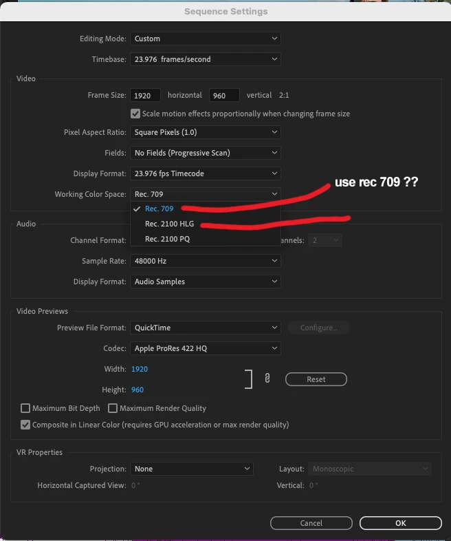

I need to understand the correct colorspace workflow
for the color space should I be using Rec 709?
Or if I use Rec 2100 HLG (Does this give Me wider gaumat of colors to work with? Or is it best practice to work with Rec 709?

Very little reason to work in HDR at this point, as very few screens actually show it well if at all. So for now, Rec.709 is a better "normal" working process.
For all of those, I would suggest a straight Rec.709 workflow. Color management settings in the Modify/Interpret Footage section if needed, and for timeline color space and exports.

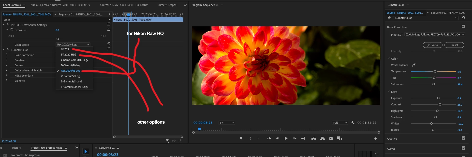

so with nikon z6 ? using raw hq prores
I would use this below
Nikon  rec 2020/ N - Log  ?
Sequence colorspace rec 709 ?
also what about exporting?
How about fujifilm Log? 4k workflow 10bit hq prores 422 hq
Sequence setting Rec 709
F-Log I hear with fujifilm is a Rec 2020 but premire Properties says its a Rec 709.
also exporting?
Thanks for your help!

xt3 has limited dynamic range so even F-log is going to perform just fine. it's easier to grade and expose than HLG as HLG is not a smooth curve like log. unless you have a rec. 2020 monitor, I doubt you will notice any color differences.
if you want to shoot HLG, just setup premiere to match it.  you usually choose your shooting for the end result, so the final playing device needs to either support HLG or you can convert to rec. 709 upon export.
