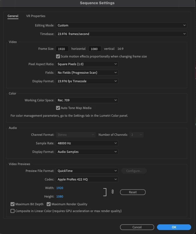

Hello Community,

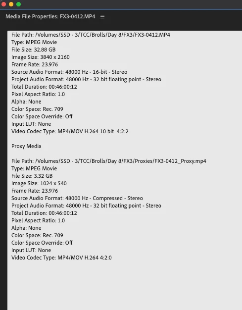

I have recently discovered that my exports are slightly desaturated compared to the colours of the videos on the timeline. I researched this issue online and found that the problem often lies in mismatched colour space management settings between your files, sequence, and export settings. In my case, everything is set to Rec. 709, but I still experience less saturated, differently coloured exports every time.
Camera used: FX3, filming in S-Log 3 Rec. 709. Both my Premiere project and timeline have the same colour specs.

Here are some screenshots:
