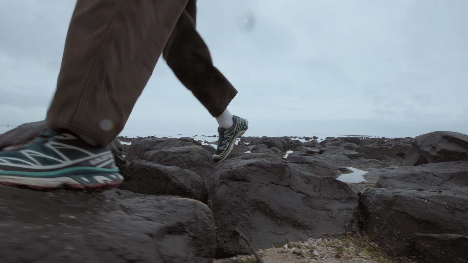

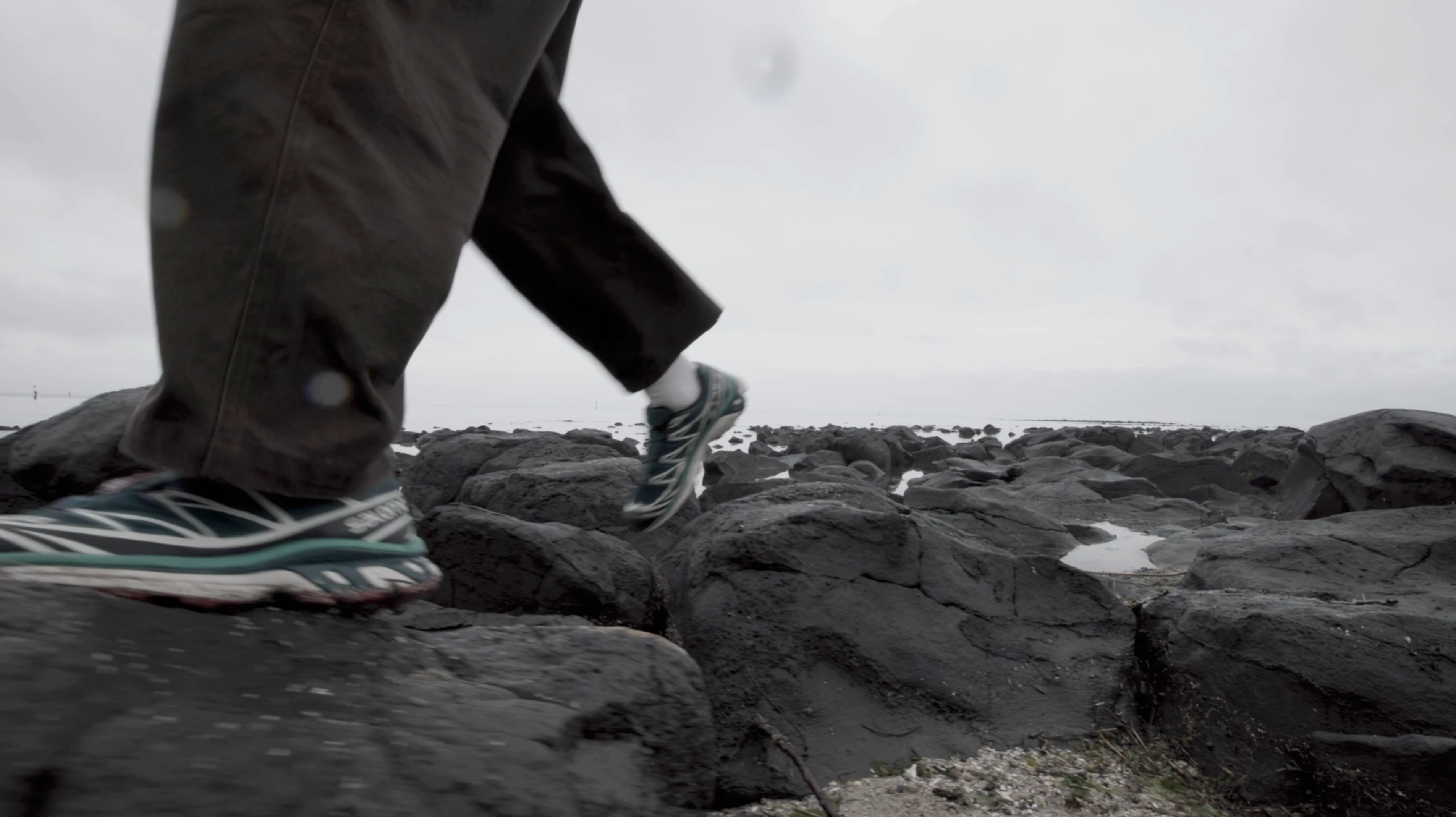

Colours/colour space is randomly changing during exports no matter the color space I'm editing in. I'm using cine gamit c-log 3 footage with basic conversion luts and am getting completely different results during an export. This even happens when I put the correction lut into the exporter rather than an adjustment layer in the timeline.

Thanks for sending through, I've got quite a lot of experience with colouring and different colour spaces and have ran tests trying different spaces. This is a version issue as I've had no problems in the past exporting thousands of projects using the same media.
