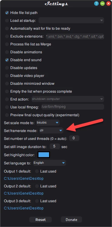

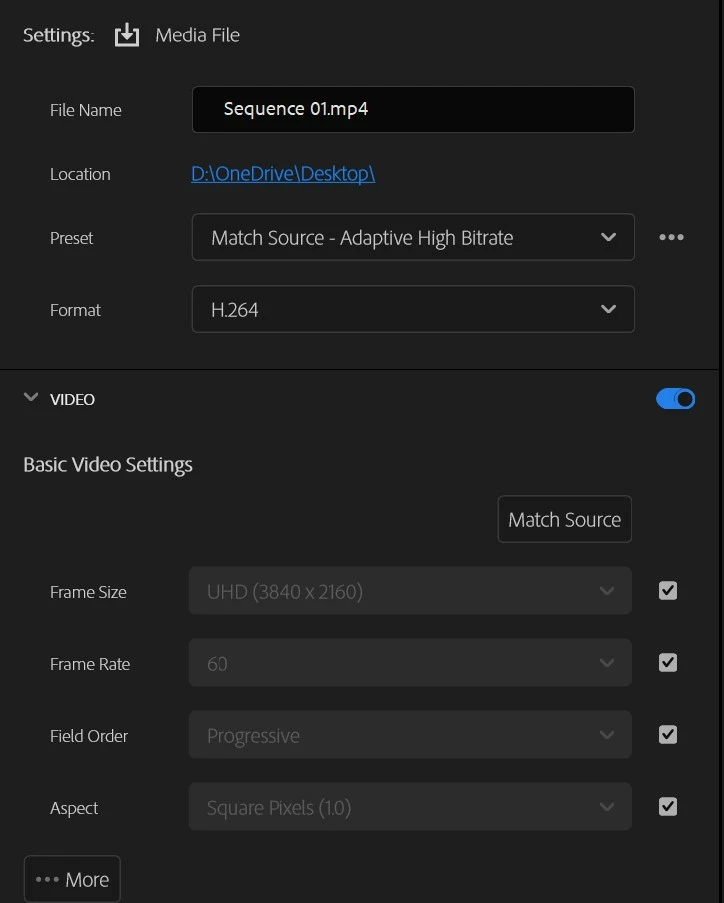

Just try out various options using a smallish source file so it happens fast. ProRes (as source files) would be used to make easy to edit files, and they may come across at constant frame rate on their own. Do check the default settings for Set framerate mode:
In PP use  20ish Mbs BIT rate (variable) for an export final file.

Jan 4, 2025 11:30 PM UTC
Also, I think your bit rate is quite a bit too high for the export file. Try a standard export preset and don't click on match source.

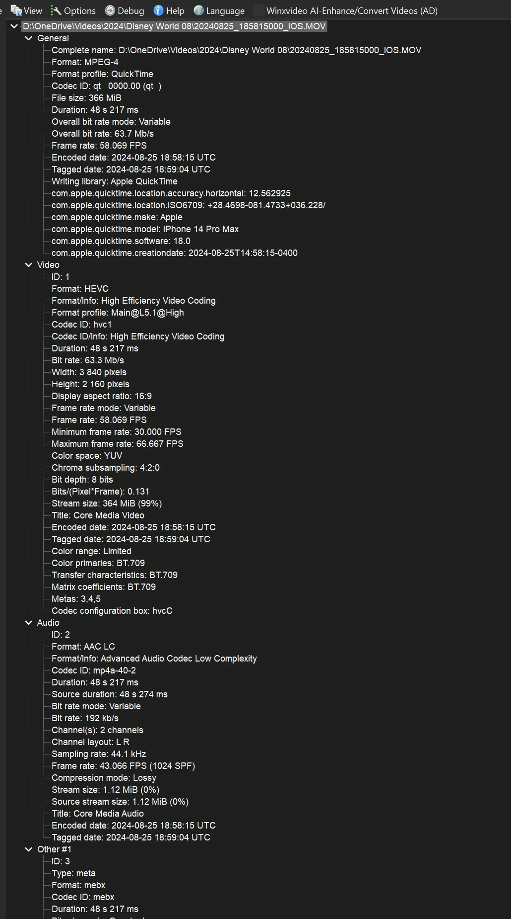

Jan 4, 2025 11:19 PM UTC
Yes, that clip is variable frame rate. It's h.265 which is the successor to h.264. It's marginal to edit with. It's typically best to Transcode into an editing format, like ProRes, proxy or LT.
Variable frame rate files, are what typically cause the problem. Use Shutter Encoder to convert the files (before editing) to constant frame rate.
https://www.shutterencoder.com/en/

Jan 4, 2025 10:53 PM UTC
Hey Mitch, well, that clip is constant frame rate. Is that the exported file? Give us a treeview of a typical clip from your camera.
Mitch MAAuthor
Jan 4, 2025 11:00 PM UTC
Apologies! Here's the info from a typical clip.

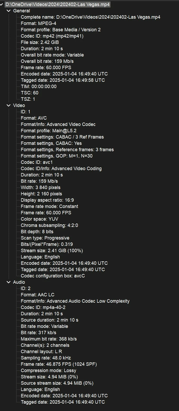

Jan 4, 2025 10:03 PM UTC
Is it version 25? Or 25.x? (.1 is current)
Yes, do post the media properties, as PB asked for. I'm curious to see if your '60fps' is actually something not nearly as good. As in Variable Frame Rate, which doesn't edit well, and PP has a distinct bad taste for.
You can use the free MediaInfo program to get info on your clips. Get the program from the link below and using the 'Tree' view post a screenshot of your clip info: https://mediaarea.net/en/MediaInfo/Download
Mitch MAAuthor
Jan 4, 2025 10:12 PM UTC
Hi! Thank you much. I'm running 25.1 and I've attached the tree view of the final file that exhibits stuttering.

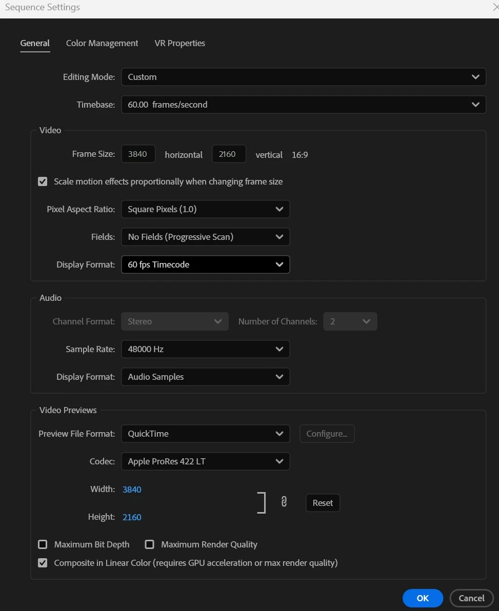

Peru Bob
Jan 4, 2025 5:49 PM UTC
Please post a screenshot of your media properties, sequence settings, and export settings.
Mitch MAAuthor
Jan 4, 2025 9:50 PM UTC
Thank you Bob, files attached.
