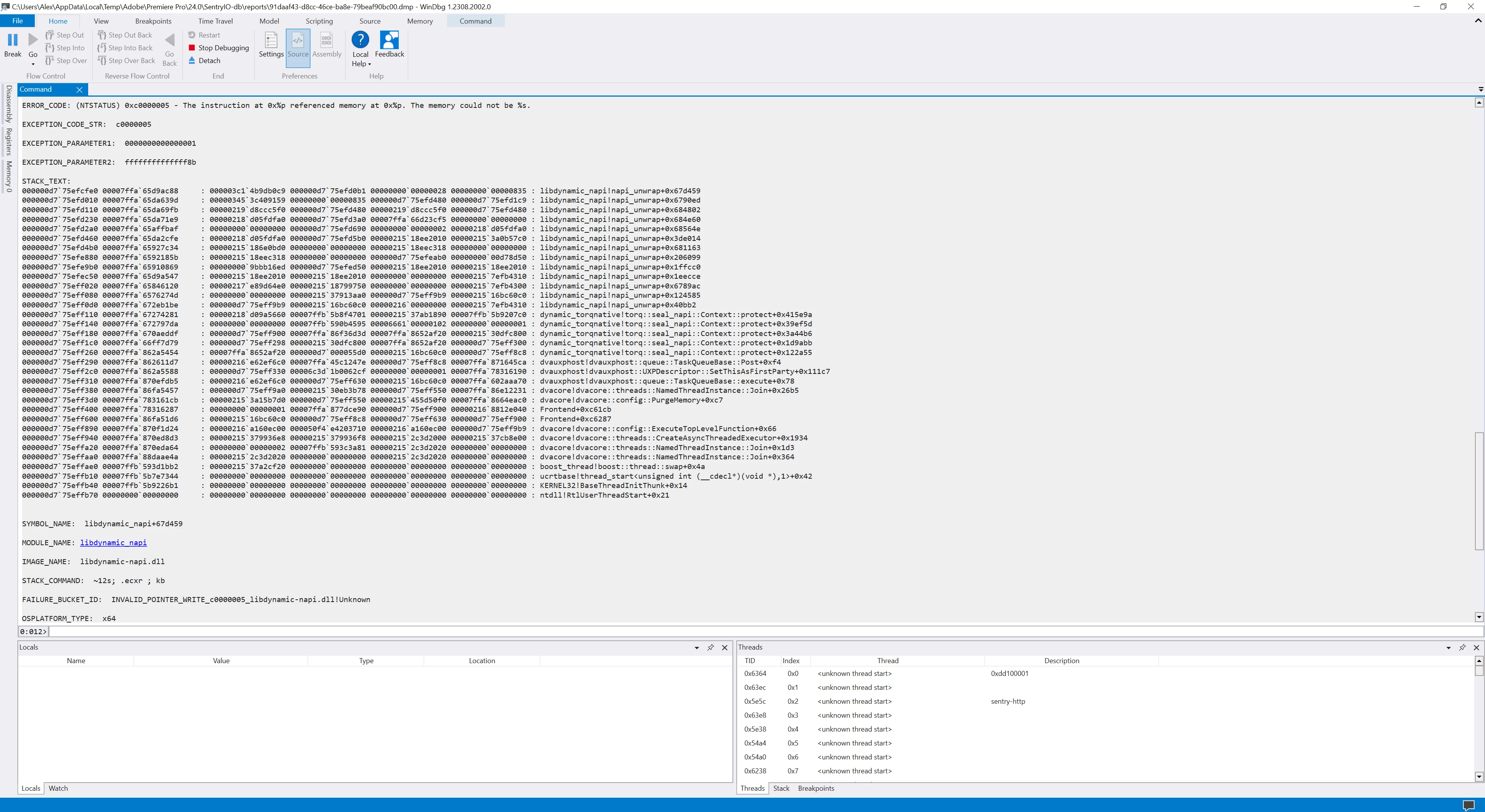

I've got a brand new high-spec PC and am facing head-scratching frustrations with this programme. I'm only having crashes with Adobe products. Sometimes Premiere or After Effects will just close on its own, other times it will freeze to the point where I have to sign out of my PC for it to shut (Task manager won't help).
Crashing when:
- Scrubbing through a .mov file
- Trying to make proxies in Media Encoder from raw camera footage
- Timeline playback
- Exporting
I have .dmp files that I don't know how to read.
Here are some things I've tried:
- Re-installing Windows
- Re-installing Adobe CC and all products
- Changing RAM (96GB downgraded to 64GB)
- Updating to latest GPU studio driver
- Increasing pagefile size to 64GB
Here are my PC specs:
- Windows 10 Pro 22H2
- Premiere 24.1, no plugins
- Intel i9 14900K 5.8ghz
- 64GB RAM DDR5
- Nvidia RTX 4070Ti 12GB currently on driver 551.23 studio
I can't roll back to an earlier version (past 24.0) of Premiere as it would affect my ability to work with others.
Any advice?
