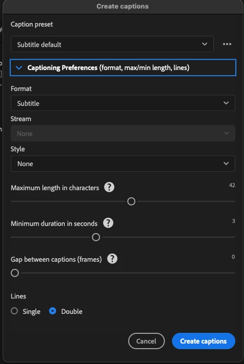

Ok, in that case I would probably do the fix up of mispellings directly in the Transcript tab in the Text panel rather than on the captions. Then I would generate the captions once in the 16:9 sequence with the appropriate settings in the Create Captions dialog and then generate the captions again using different settings for the vertical sequence. Would that work?
This is the dialog I mean:
