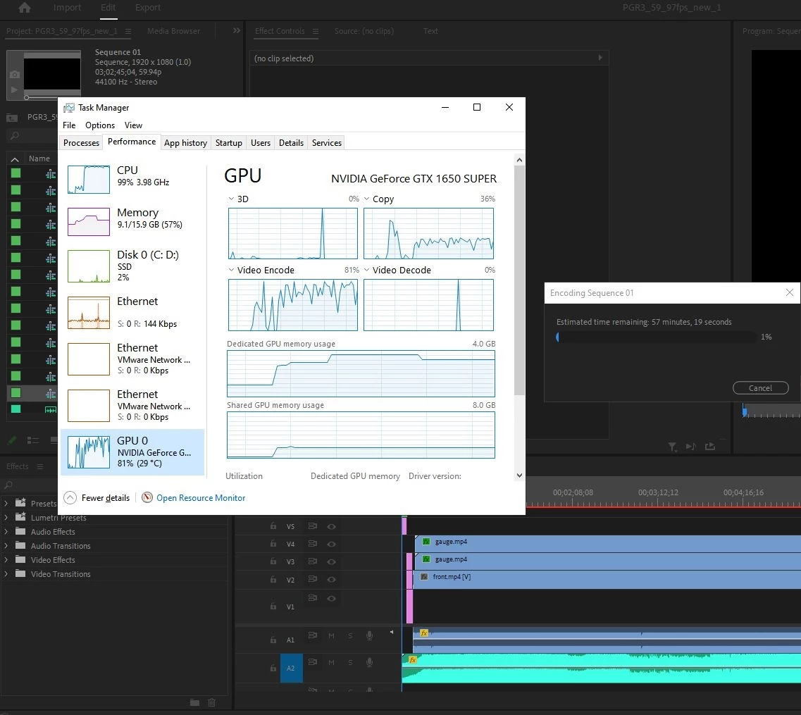

In attatchments screenshots showing computer resources during exporting and after crashing:
pp1.jpg - begenning of exporting

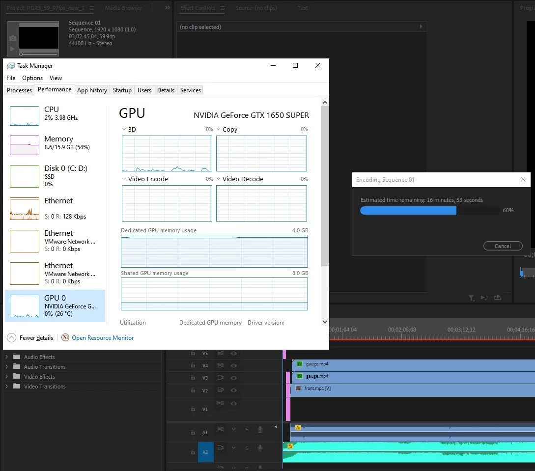

pp2.jpg - freeze at 68%

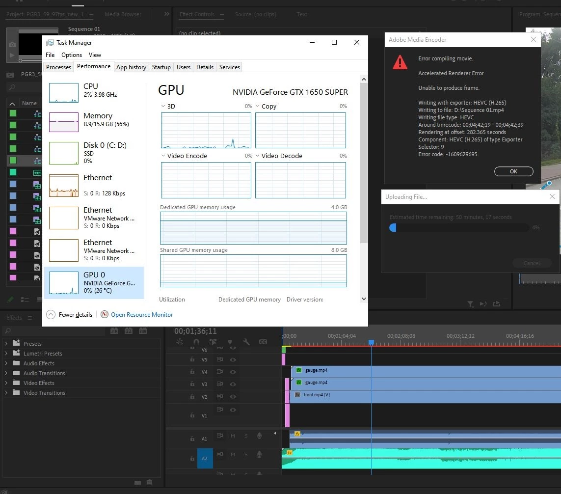

pp3.jpg - error -1609629695 at 4%

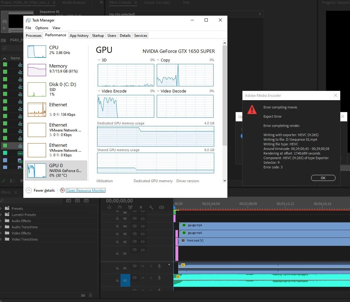

pp4.jpg - error 3 at 26%
