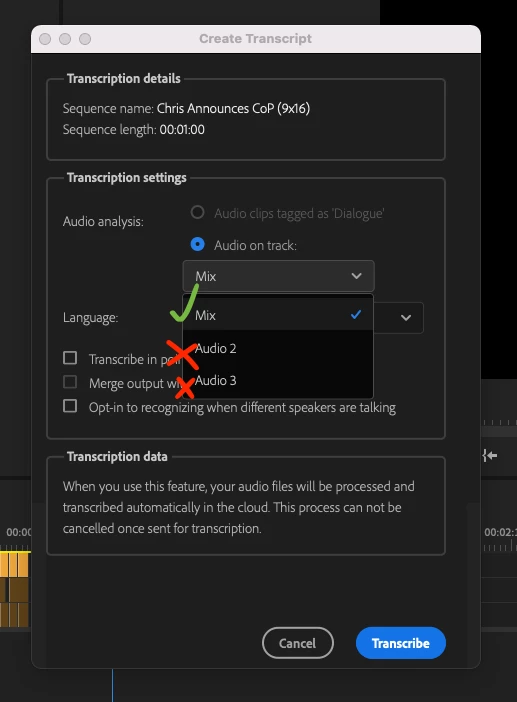

FIX (for me at least)
I was having this issue when I was sending a single audio track to Adobe. I changed the setting to "Mix" and it worked again. The timecodes were off when I had it set to the single audio track and I think that was the problem.
