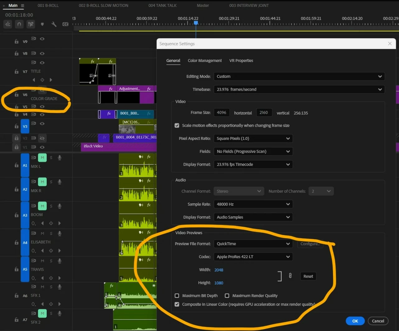

March 10, 2025
I had the same problem (with the multi-cam playback monitor view only - single cam playback window was fine without the following adjustments), until I turned my color grading layer off. I also reduced the sequence playback settings. This eliminated my issue. The color grading adjustment layer seemed to contribute significantly to the issue. I simply turn the multi-cam view off when and work with a single view in the playback monitor when working with the color grading adjustment layer on. Hope this helps someone out there!
