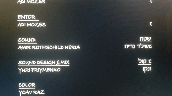

Hello ,
I use PNG file for roller on Premier according to my format 4k
And when I put it on Time Line first I can't see the whole roll. And after a few moments, the roll gets on
when I export in 4k  or UHD the roll  look like this . Export  in HD or lower format it's ok .

yeah, but it looks upscaled... like did you make the title in lower res, upscale it to 4k and then add to timeline ?
I don't know why it would look like that if you made it in 4k to begin with.

OK the canvas need to be lower then 4K and also the image size . lets say UHD will work.
Thanks for your help.   salvo34

looks like you have a conflict between the source file dimensions ( the title png ) and the timeline.
I usually use photoshop to do titles for the NLE's I use, and export as psd or png as needed.
What I see from your animated gif is some problem with the dimensions.
check the specs of the title image and timeline.
If it's that problem you can just go back and make a new png and replace that...

My footag are UHD same as the project
The Png is 4k I chenge it to HD and UHD but still got the same problem when I export UHD or 4K .

There is an excellent and simple way to make a Roll with the Legacy Title tool. But, tell us how you are doing it and how you are exporting it because what you tell us is quite rare.
Byron.

Legacy . it's nice but not for hebrew
