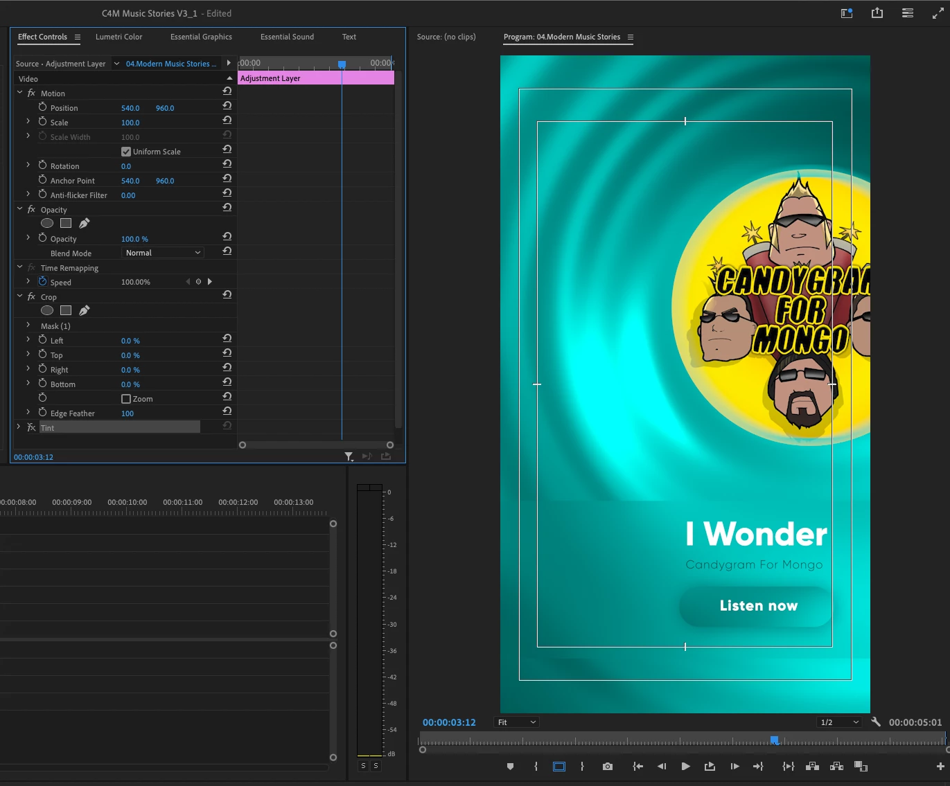

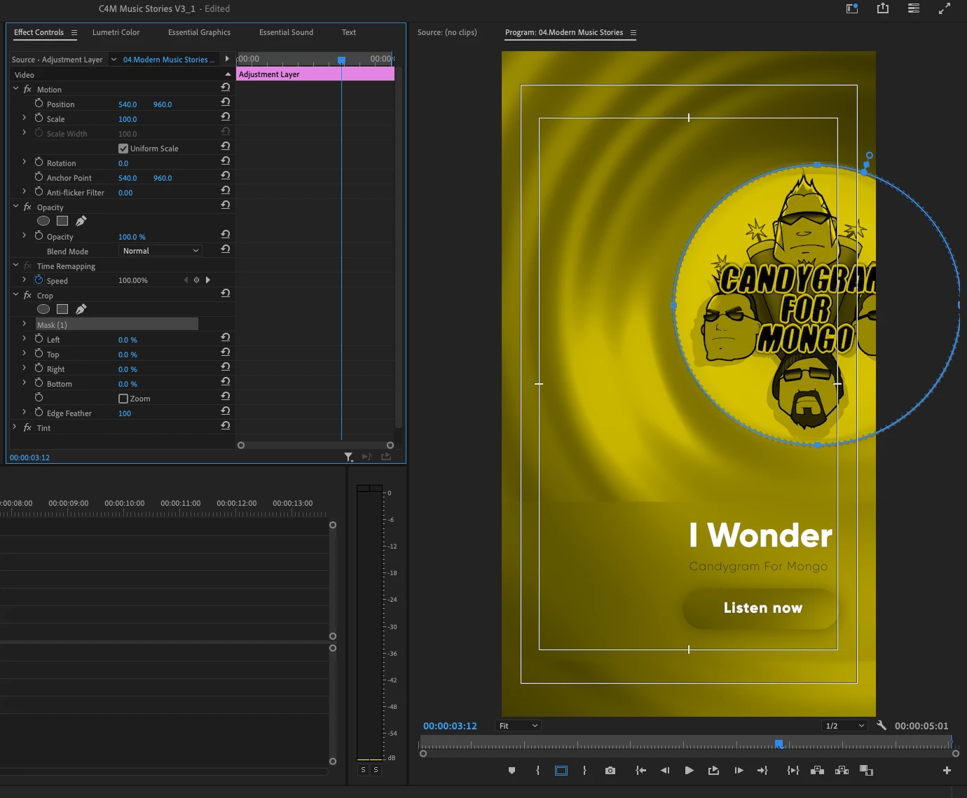

Hello - I created an adjustment layer for a color tint.  I want to crop a circle out of that adjustment layer, so the layers beneath are not affected by the tint in the area I mask.
I added a crop effect to my adjustment layer > created and placed a circle where I needed it to be.
Nothing.
Everything is still tinted underneath that cropped area.
What am I doing wrong?
I've attached two screenshots before and after.
Thanks!
Correct answer Ann Bens
Do not mask on the crop effect (dont go together very well)
Mask on Opacity.
Ann Bens
Ann BensCommunity ExpertCorrect answer
February 26, 2024
Mask on Opacity.
February 26, 2024
Thanks so much!
