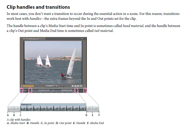

Option Crop as in trimmed?
If you want a cross dissolve on both connecting clips both of these clips need to be trimmed (clips need handles).
If you want a 1 second transition in the middle of two clips with a framerate of 60, both clips need to be trimmed 30 frames.
If only one clip is trimmed then only one clip will have the transition showing.
Applying transitions in Premiere Pro - handles

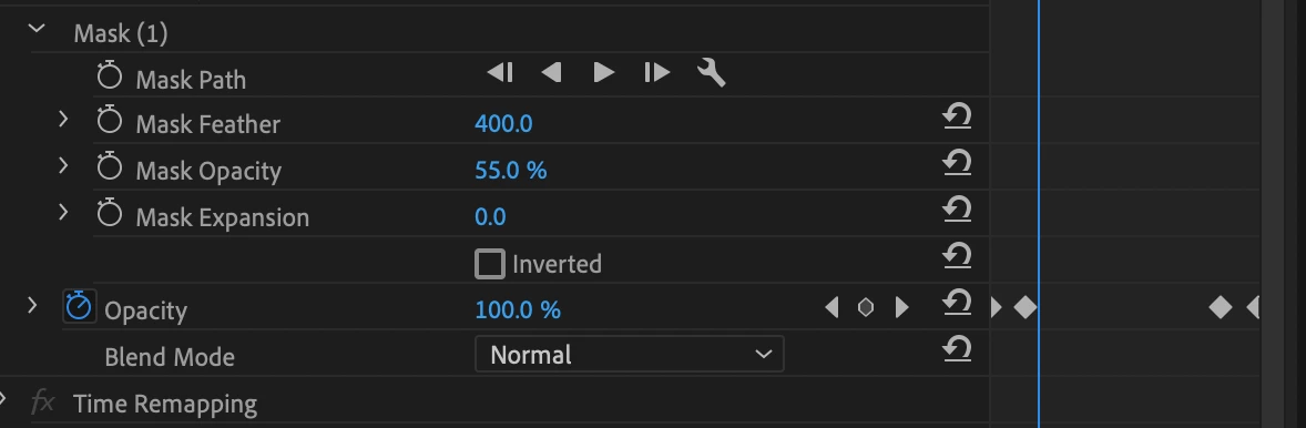

Today I was editing in Adobe Premiere Pro 2023 on an M1 24 inch iMac and found when I added a cross dissolve to a mask and text object there was a glitch. I tried hiding each layer and found it was the mask that was causing the issue.
How to fix it
I removed the cross dissolve and manually keyframed the opacity. Problem solved!
