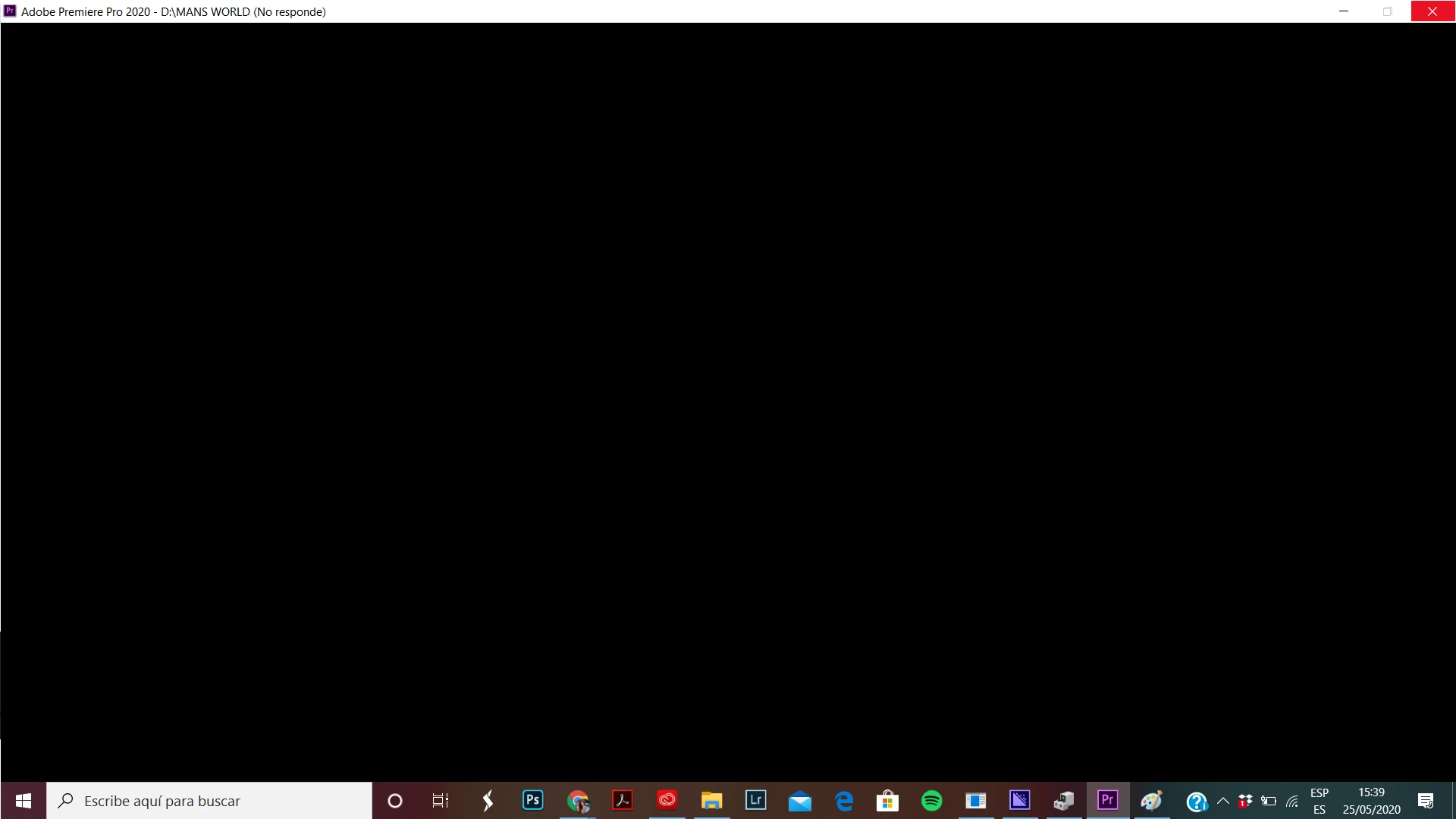

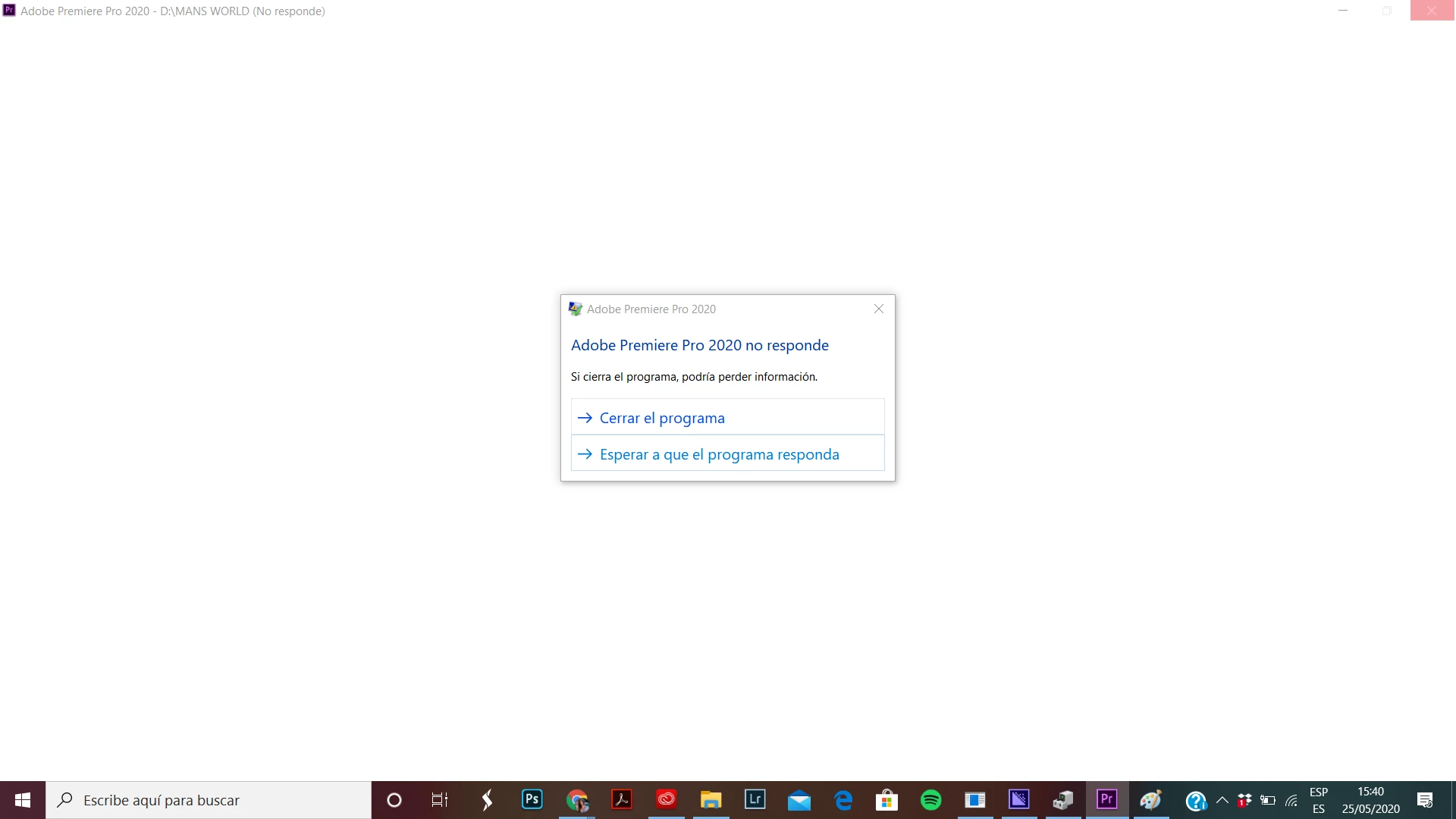

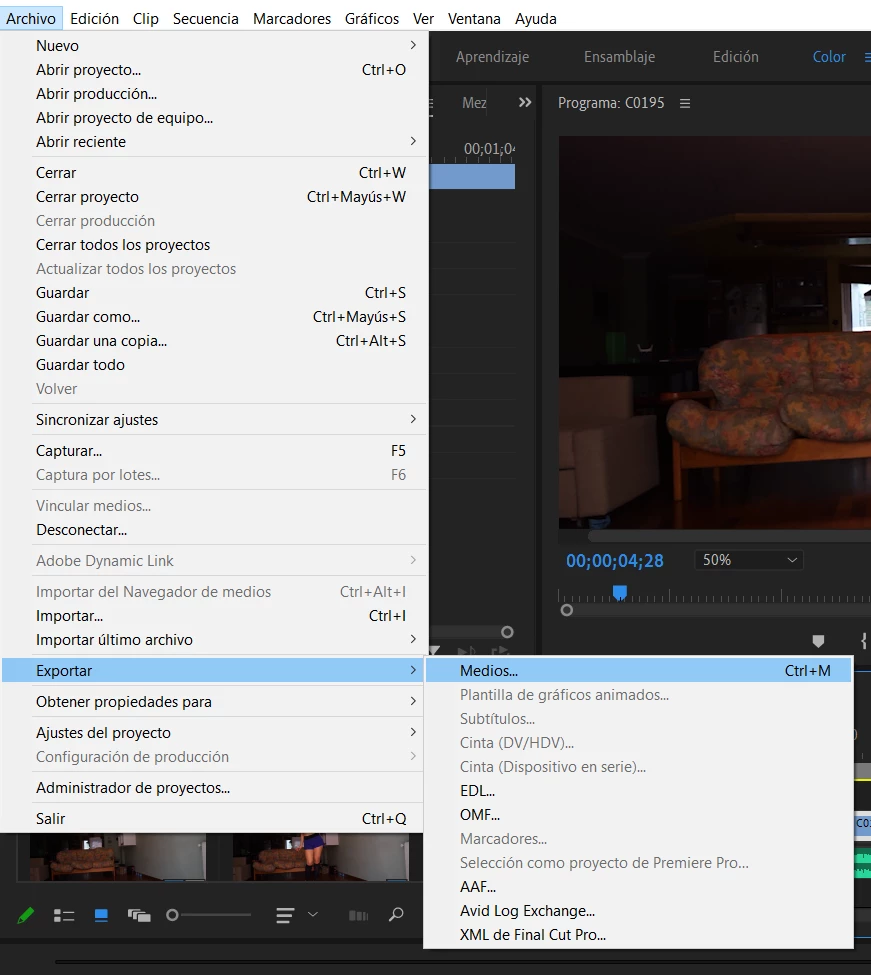

NECESITO AYUDA. Tengo un problema al exportar y es que no me sale la pestaña al hacer click en exportar medios premiere deja de funcionar, y tengo que cerrarlo. El programa me funciona normal excepto porque no me deja exportar (no me sale ni la ventana y simplemente se cuelga) he probado de todo, desinstalarlo, actualizar drivers de la tarjeta gráfica y ya no que hacer. Hay forma de exportar por adobe media encoder sin tener que abrir la ventana de exportación de premiere? Es posible que haya creado algún fallo en la tarjeta gràfica al actualizar el driver? No se trata del proyecto porque he probado con muchos./
When I click "export media" Premiere does not open the window and the program stops responding. I have a problem when exporting and it is that the tab does not come out when I click on export premiere media it stops working, and I have to close it. The program works normally for me except that it does not allow me to export (the window does not appear and it just hangs) I have tried everything, uninstalled it, updated the graphics card drivers and no longer what to do. Is there a way to export by adobe media encoder without having to open the premiere export window? Is it possible that you have created a fault in the graphics card when updating the driver? It is not about the project because I have tried many.

la solucion es activar el servicio asistente para la compatibilidad de programas en services.msc
