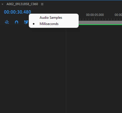

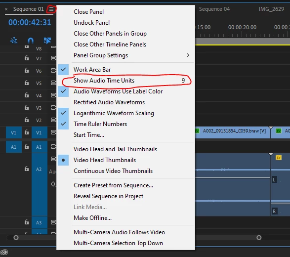

Select 'show audio time units'.
Then right click on the timecode numbers and select milliseconds.

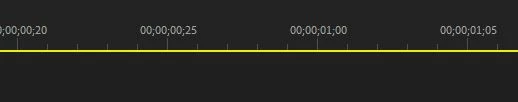

I thnk you'll find they are frames not miliseconds.
HH:MM:SS:FF, It looks like you have 30 frames/sec so the frames will count to 29 then the seconds will increase by one and the frames will reset to zero.
