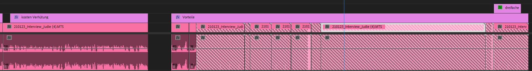

Hey everyone...have a big problem with a huge movie project. Since several movie files had the same number (e.g. 0000.MTS) Premiere had random bugs towards the end of the edit and mixed e.g. picture and sound from two different files with the same file name.....for a restart I gave all files an individual name. I started relinking every single file. But when linking the files, these dashed clips appear. It is the right file. It has no sound in Premiere (you can see it in the screenshot). Did you by chance have a similar problem? Have now tried for hours all kinds of things (clear cache...), tips from the Internet, ...I am desperate....At last I started a new project and "replaced footage" (instead of turning media offline and relink with the new ones). With the interview footage of the first protagonist it worked, with the second one the dashed clips appear again, although the file is correct. Hopefully someone knows something to help! Thank you in advance! You would save so much work and time for me....

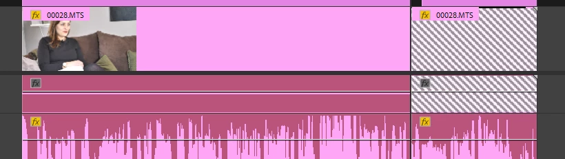

I just edited a little bit to make a one minute Outtake-Video - even there three big bugs appeared. Premiere constantly mixes up the Files (because some have the same file Number, although they are all in different folders) So I see one person but hear the audio of a different person from another file.   But just now an even weirder bug happened (see the video attached), it took me a while to figure out what Premiere did, because it's so weird:
It changed the audio of one file and replaced it with a music file (which has not even the same file name). How can this even happen? I'm almost freaking out. Any advice on this? Would it help to install old Premiere versions? (I have automatic updates - so right now it's Premiere 2022). I have a feeling premiere is overwhelmed with this big production...
