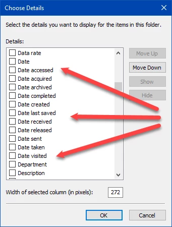

Yes, as per Stan's comment, there are many date fields available in a file. Some of those file date changing utilities can access many/most/all of those dates. As Stan mentioned it could be any one of those dates so do some experimenting.
Here's the screen for Windows Explorer, if you right-click the heading bar, you can select to display various fields:

I know, that's bizzare. None of those reads the time that is read on the Premiere.
