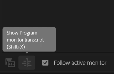

So you appear to have source media transcripts. To confirm, in the transcript tab, click the 3 dot menu. If it has an option for "Generate static transcript...," you have source media transcripts. If it has an option for "Generate text-based editing transcript...," you have a static/sequence transcript. In the latter case, you may also have source media transcripts. To "remove" the static transcript and return to source media/dynamic transcripts, select the "Generate text-based editing transcript" option.
There are multiple ways to transcribe source media. I think the method you are using should be fine.
In the screenshot below, the highlighted icon, as shown by the tooltip, is the sequence/timeline/Program Monitor view. The icon to the left is the Source Monitor view. With "Follow active monitor" checked (I prefer this), if you click in the timeline, you will be in Program Monitor/timeline view. You see the source media transcript of what remains of your clip after editing. And in this view, you can delete filler words and pauses. If you double-click on the clip, it opens in the Source Monitor, and when you switch to the Text panel/transcript tab, you will see that the left icon is highlighted, and it is in Source monitor view. You see the whole transcript of the clip. You should see any filler words/pauses that have been identified, and you can filter by them. But the delete button will never be active, because you cannot delete part of the file itself. You can delete them in sequence view.

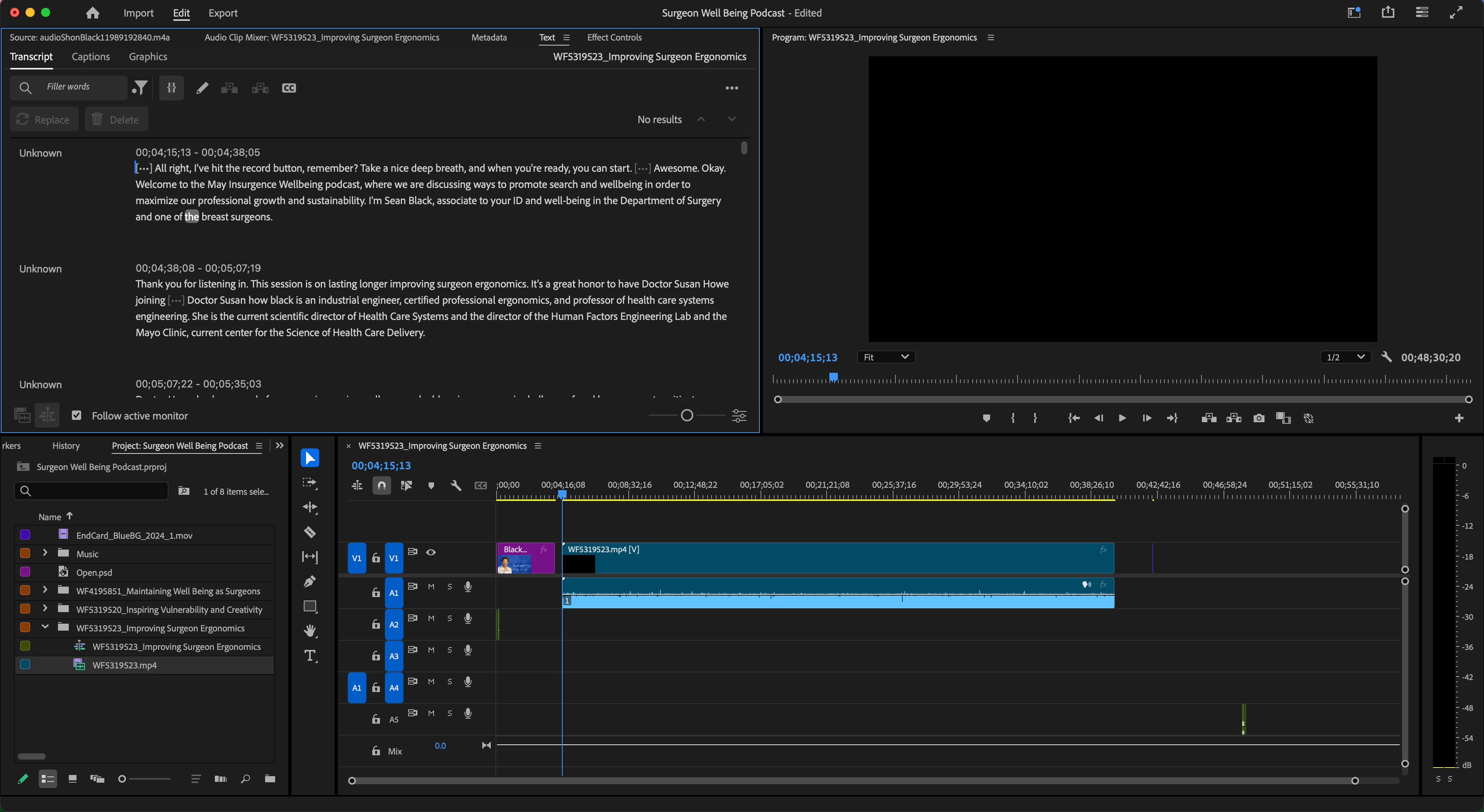

Jan 1, 2025 3:32 AM UTC
@richard_3982,
I suspect you have no filler words. I do not see any in your screenshot. A filler word appears as "[filler]" just as a pause appears as "[...]".
If you have no filler words, you will not see any in the transcription and the delete button will be greyed out.

Dec 31, 2024 5:58 PM UTC
No, I don’t think so. I selected a pause from the transcript and the button is still grayed out.
Rick
