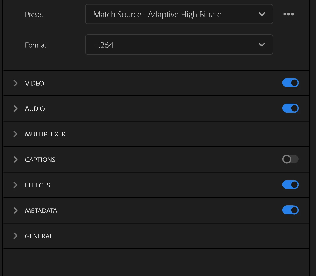

I need help with a related issue. I am using Premiere ro gnerate SRTs and caption files, which are being used in a different platform. I typically generate the captions after having exported the video. However, I need to make changes and re-export the videos without captions. I can certainly hide the caption track and export that way, but I have so many sequences and doing this manually to each sequence is very time consuming. Is there a way to disable the caption track for the entire project temporarily while I export the videos?
Jan 8, 2024 9:35 PM UTC
I'm not exactly sure how you have your sequences set up but when going into the export window, there should be a caption switch you can turn off. This will disable all captions during export, regardless if they are activated in the sequence.
