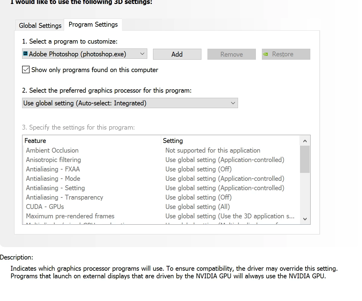

- enter the 3D settings, here you are prompted with 2 tabs: "global settings" or "program settings"
     - for global, this will enable your PC to run your GTX 960M as your primary choice of GPU.
     - programming settings, gives you a control of which programs you want to open specifically to run with your GTX 960M
- for this purpose, I'm recommending you use program settings, and set which ones exactly you want to benefit from your GTX 960M for better performance, the rest can utilize the onboard intel 530 (ex: browsing the internet). This method further eliminates the XPS way of thinking, which GPU to draw performance from, and I myself have not experienced any issues with my laptop. there are some lag spikes, but I'm positive its from the lack of VRAM that the GTX 960M has to offer on laptops, which I believe is only 2GB of VRAM? don't hold me to that tho.
here are some pictures of this suggested method. hope it helps.

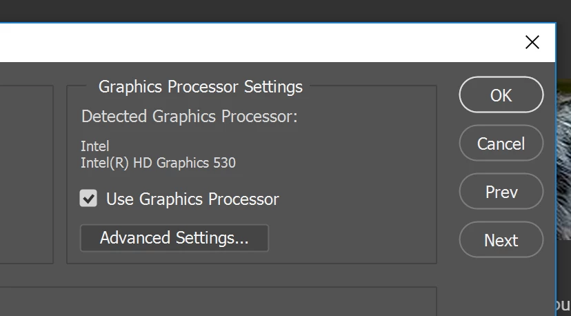

Photoshop: Before manually switching to the 960m

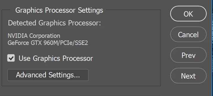

Photoshop: After manually switching to the 960m
GPU settings: as shown - the list of "Features" is derived through the "global Settings" tab, which is defaulted to " auto-select ". Meaning it cycles between integrated GPU (the intel 530) and the GTX 960M
