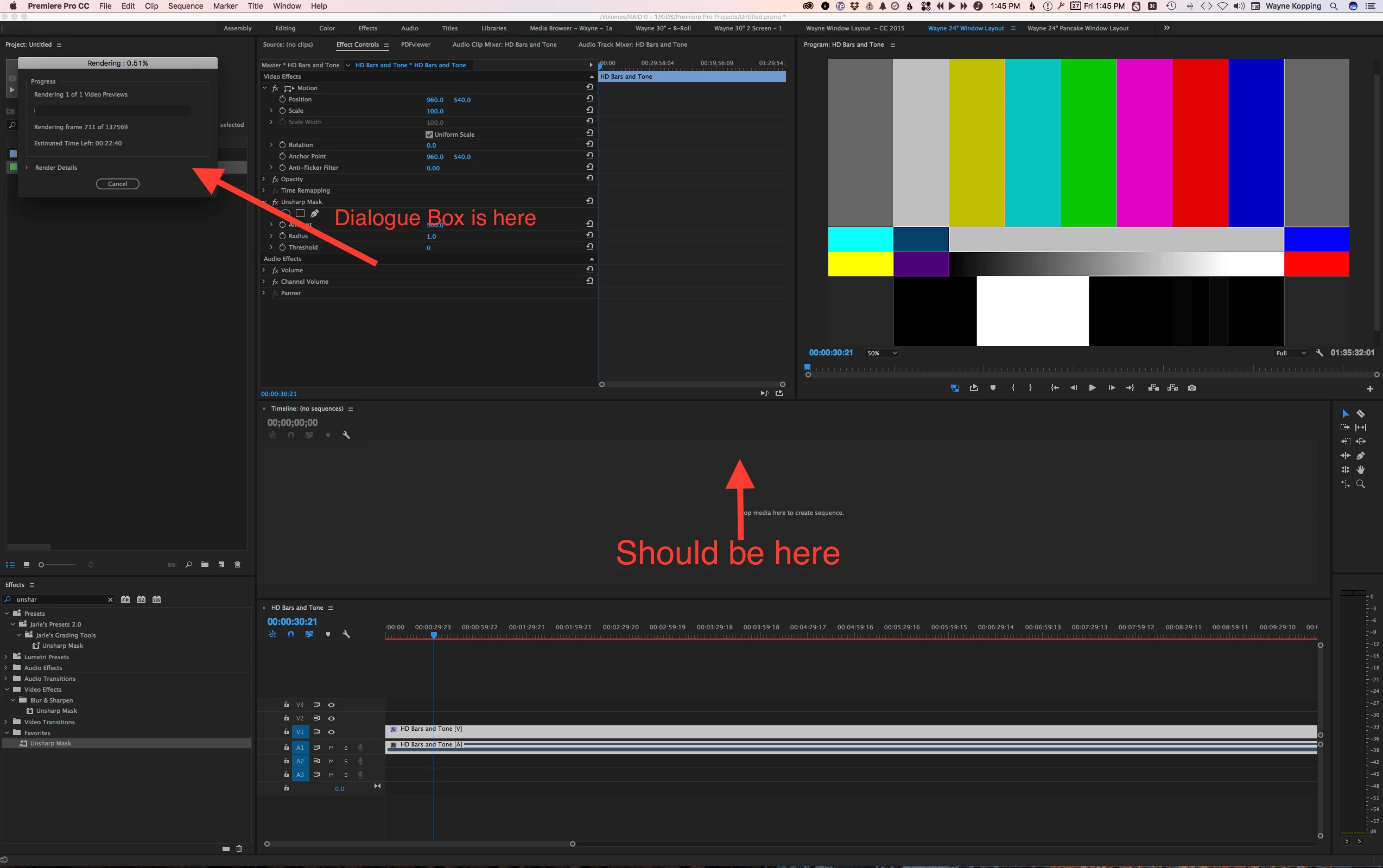

This is not a major crisis, but is annoying, so would love a fix for this.
A couple of weeks ago, my 30" Dell Display, which was my primary editing display, died a painful death .
Fortunately, it was under warranty, and Dell offered to replace it, [which was amazing, thank you, Dell!]
Whilst I was waiting for my replacement, I used my old 24" Dell display so that I could continue editing, and obviously,
I had to resize PrP to fit the smaller screen.
When I got the replacement screen, I had to resize PrP to fit the larger display - but now the Save/Render dialogue bar
always shows up towards the upper left of the screen [which is where it was due to the smaller display] - and NOT in the centre of the
30" display.
How can I reset that setting or cache, or whatever, so that PrP displays the dialogue bar in the right place?
Resetting the Windows Layouts doesn't seem to help with this issue. No matter what Windows Layout I choose, the dialogue box is still on the t upper left of the screen.
Thanks in advance,
W.
    Correct answer stefan_gru
    I think the dialog box placement is sticky. I rendered a sequence and saw that the Rendering dialog box appeared in the middle of the screen. So I moved the dialog box during the render process (to the upper left corner) and then canceled the remainder of the render. When I rendered the sequence again, the same dialog box appeared where I had just moved it. So I moved it back to the middle, canceled the render, and then rendered again and saw the dialog box appear back in the middle of the screen. So why don't you try that yourself — place it wherever you want it to appear — and then cancel the render and see if later renders display the dialog box where you want it, even after closing the app and reopening it.

    bkgarceau
    November 9, 2017
    This is an issue I've had for years on my MacBook Pro. Same exact placement doesn't matter the monitor or layout... Reseting preferences hasn't helped and this has been an issue across a few different versions of Premiere. Certainly feels super rare as I almost never even come across posts that even mention such an issue.
    For the record the same layouts work on my other Mac without any issues in Dialogue Box placement... so there you go... more questions.
    Anyway, I'm curious as the next person to know what in the world is causing this issue.
    stefan_gru
    stefan_gruCorrect answer
    November 9, 2017
    bkgarceau
    November 9, 2017
    Oh that is messed up! It actually worked! But the key was CANCELING the Render after moving it. If I let it finish or do anything else it just reverted to the original place it was. But once I had moved and canceled it seems to be good there.
    The only catch is my other dialogue boxes (i.e. a project loading) still appears in the top left corner. Alas, the Render Box is the most annoying one to see out of place and now that its back in order I don't think the others bug me.
    Thanks for the tip Stefan!

    Vidya Sagar
    January 27, 2017
    Hi WMK,
    Please post a screenshot FAQ: How do I capture and post a screen shot or video?
    Vidya Sagar.
    WMK
    WMKAuthor
    January 27, 2017
    Hi Vidya,
    Here you go.
    W.
    Ann Bens
    January 27, 2017
    Does it also happen when using a default workspace?
