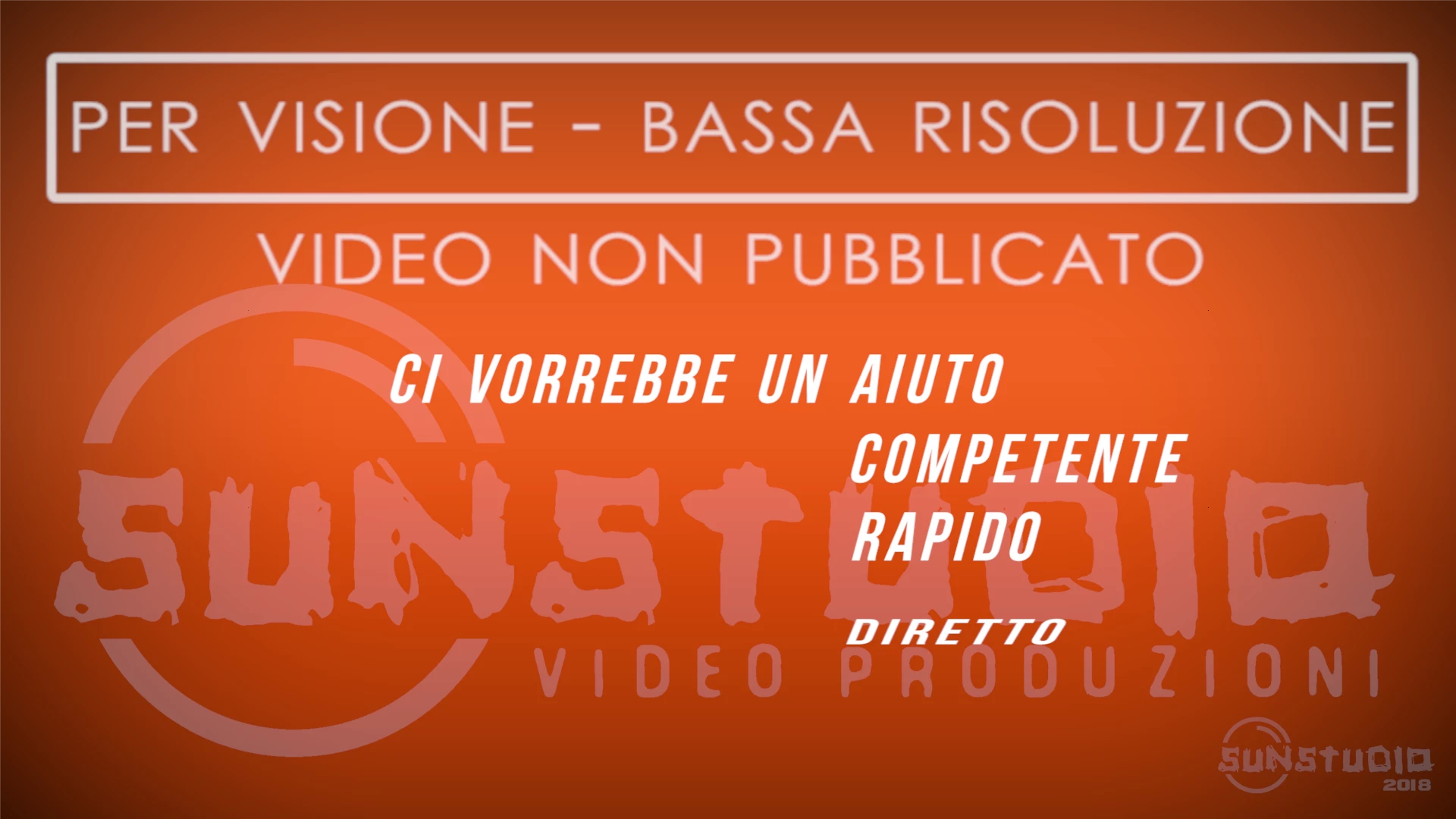

    Meanwhile, I wanted to put a part of the graphic animation that I want to create, only that I did not understand why you can not post as you do for an image; I must necessarily put it on a site like Youtube?
    I had not thought about the discourse of the dimension concerning the whole frame; actually it works like this also for the clock transition;)
    Here it is an image. As you can see, the title that is appearing from the "diretto" words rotation, has its anchor point at the bottom and not above as I would like; what I'll try to do now.

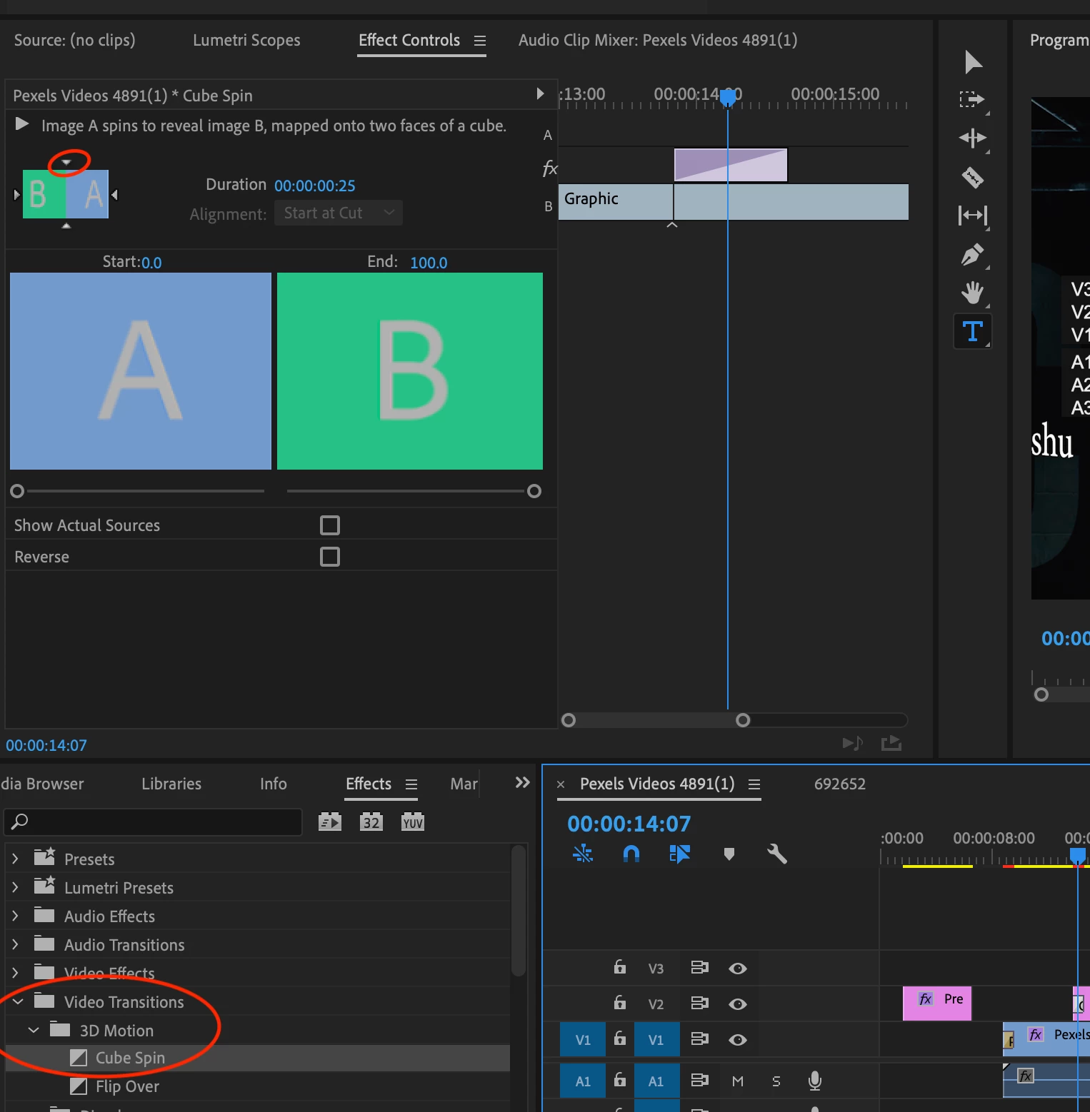

    I am not sure whether it will work as per your requirement but you can try out the Video Transition. Effects panel > 3D motion > Cube Spin > Apply it as the start of a text clip or end of it...then select the transition & in the effects control...choose top.

    January 21, 2019
    Nothing to do: the effect does not give what I wanted to recreate because I wanted the text and then the movement to start from a specific point.
    I'm afraid it can only be done with AE.
