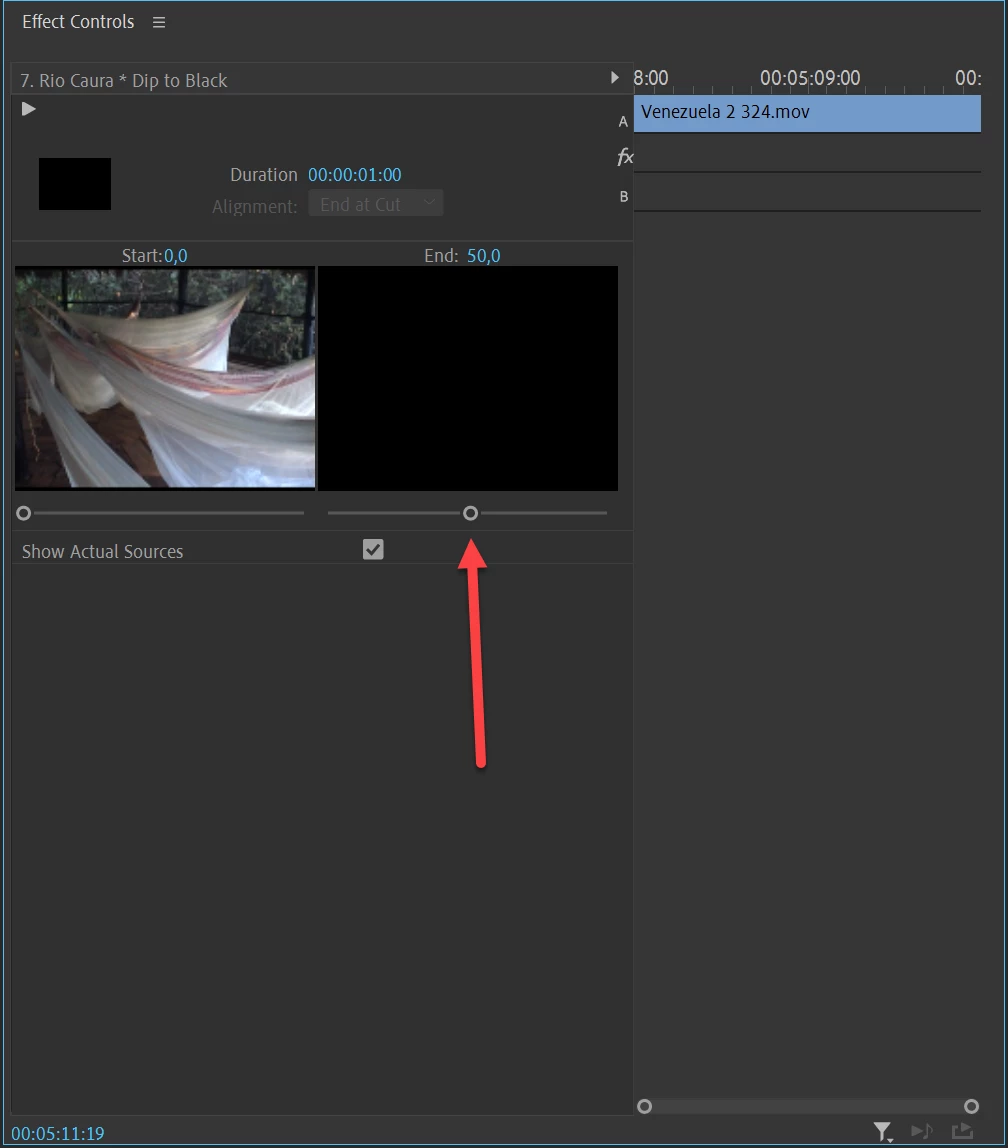

When I use Dip To Black, I have too many frames of black at the end of the fade.  There are a full 15 frames of black at the end of the dip/fade.  I know how to shorten (or lengthen) the duration of the overall fade, but I don't see a way to end the clip as soon as it is full black, or cut down the number of full black frames at the end of the fade.  Is this possible?  Thx!

Dip to black/with is best used as a double-sided transition.
When used as a single sided transition, you will have to set the outpoint to get less black or a more gradual fade.
Alternative, nest and use a cross dissolve or superimpose a keyframed black color matte.
October 12, 2021
Actually, I think "Film Dissolve" might do the trick.  For some reason "dip to black" includes 15 frames of black at the end of the fade, maybe because like you say people use it as a cross disolve, whereas the film dissolve ends when it hits full black.  So that should solve it.   Thx.
