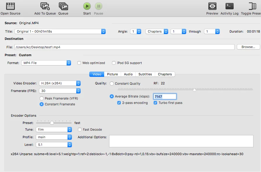

    Handbrake has a built-in 'gotcha' ... to actually get CFR out, you need to both click in the little circle of the video tab for "CFR", and ... set a specific number frame-rate setting in the box above that. If you use an 'auto' or 'same-as-source' setting for frame-rate, you will get VFR out no matter if you've set the CFR button "on" or not.
    That might be your issue.
    Neil
    Everyone's mileage always varies ...
    August 3, 2017

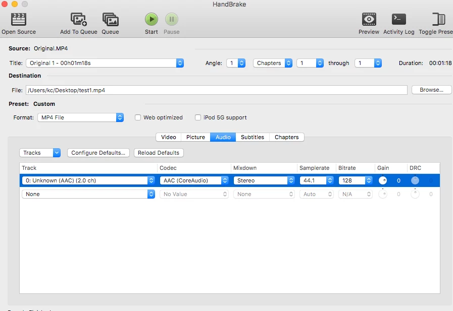

    Thank you for getting back so quick. Yeah, unfortunately that isn't issue. Here are my settings. I should mention the video was created as a screen record in an ipad.

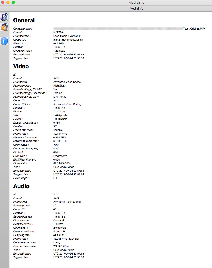

    And this is my Media Info Doc from the original file
