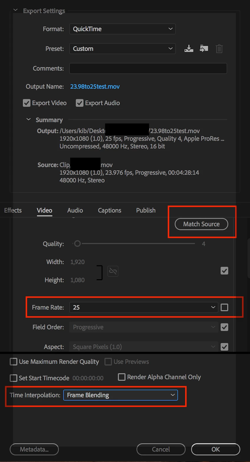

If you configure Adobe Media Encoder to convert to 25fps and set the Time Interpolation to Frame Blending it should work.  I tested on a 23.976, converted this way, imported both into Premiere, put both in a 25fps sequence.  the 23.976 clip had duplicate frames, the 25fps converted one was fine.  Using AME means you can batch encode or even set up a watch folder.

Thanks for the reply!
The process you outlined worked very well and there are no more double frames.
However (and i know I'm asking a lot here....) is there any way to limit the blur on the motion of the clips? Or is this just a product of the Frame Blending and there is no way around it?
