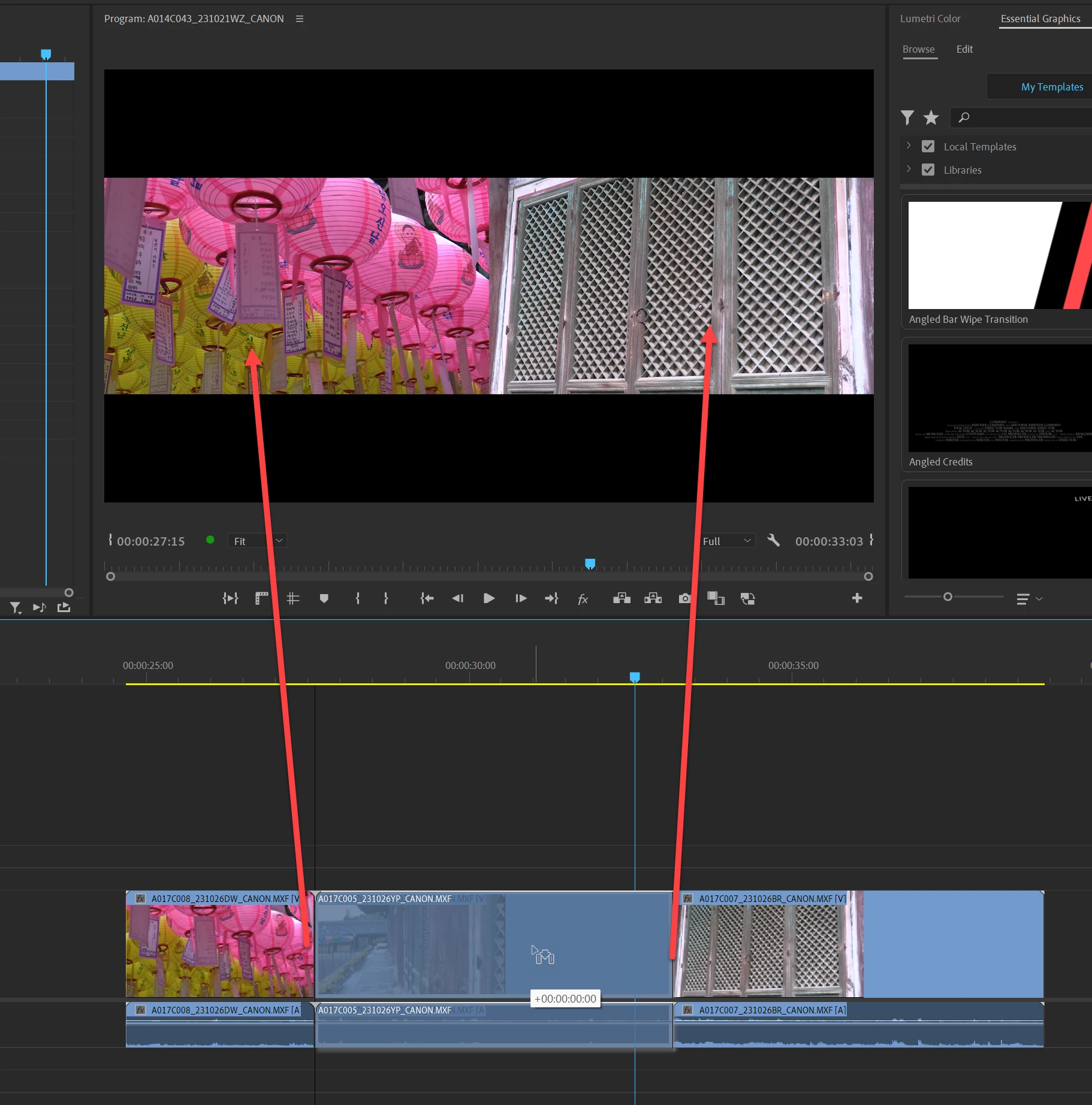

Ann Bens
Mar 8, 2025 1:15 PM UTC
quote
Dragging to trim a clip hides all layers above and below it
By @defaultgzkxy7o55slh
Giving it another good look, I say its normal behavior.
It only shows the track on which the clip is sliding/trimmed.
while sliding it will give the last frame of the clip on the left or first frame of the clip on the right.
If there is no clip on either side of the sliding clip it would show as black.
If the top and below clips where showing you would not see what you were trimming.

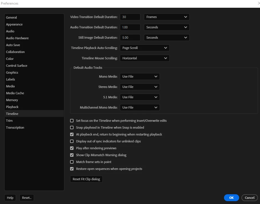

Hey @defaultgzkxy7o55slh
Hope you are doing fine!
Well that's not a stupid question at all - you're likely dealing with a setting that was accidentally changed. Based on your description, it sounds like "Trimmed Layer Preview" or "Live Preview During Trim" is enabled. Try one of these solutions:
1) Disable Trim / Drag Preview
- Edit > Preferences > Timeline
- Uncheck "Show preview during trimming"

Mar 8, 2025 7:18 PM UTC
I don't seam have any setting that mentions trim previews

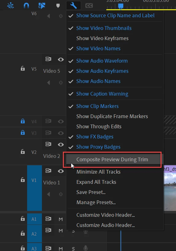

Mar 7, 2025 10:24 AM UTC
Mar 7, 2025 8:07 AM UTC
You can change this behavior by adjusting a setting in the Timeline:
  • Click the Timeline Display Settings (wrench icon) in the Timeline.
  • Check Composite Preview During Trim.
With this option enabled, Premiere Pro will display frames before and after the trim point for all tracks, instead of only showing the frame after the trim point for the trimmed track.
However, when dragging a clip in the Timeline, the Program Monitor only displays frames from that specific track. If no frames exist on either side, the monitor will appear black.
Mar 7, 2025 5:06 PM UTC
I understand that enabling the composite preview during trim would display all layers beginning and ends of trim points as well as the fact that dragging clips displays the beginnings and endings of tracks of the layer i'm am dragging it into, however my previous preferred settings would have the program monitor not display the beginning and ends of dragged clips, it would simply show a composite preview of the frame the playhead is on with all layers still being visible. As well as trimming (by dragging the sides of clips) would only show one preview window of the side of the clip I was trimming. Is there any way I can go back to this?
