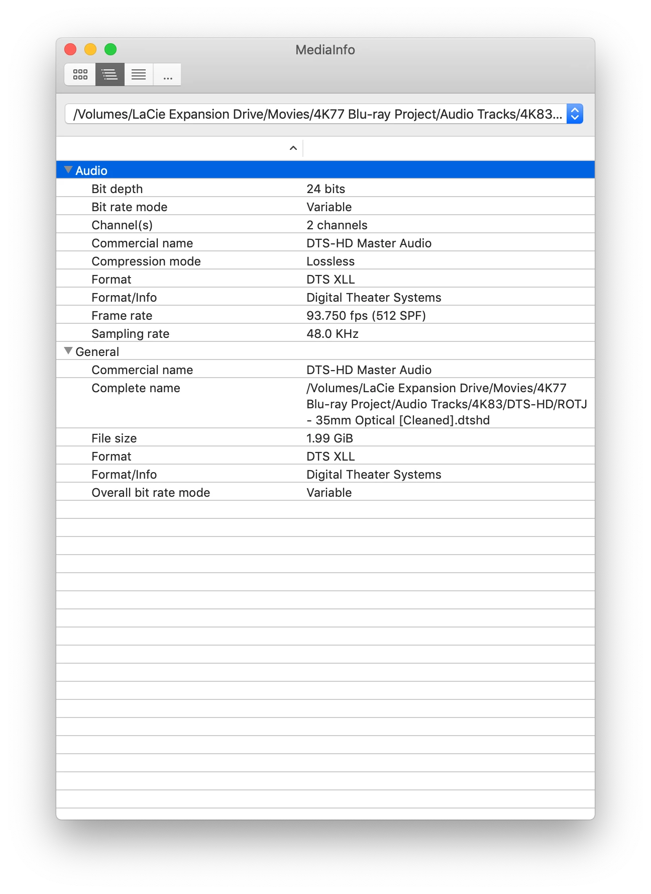

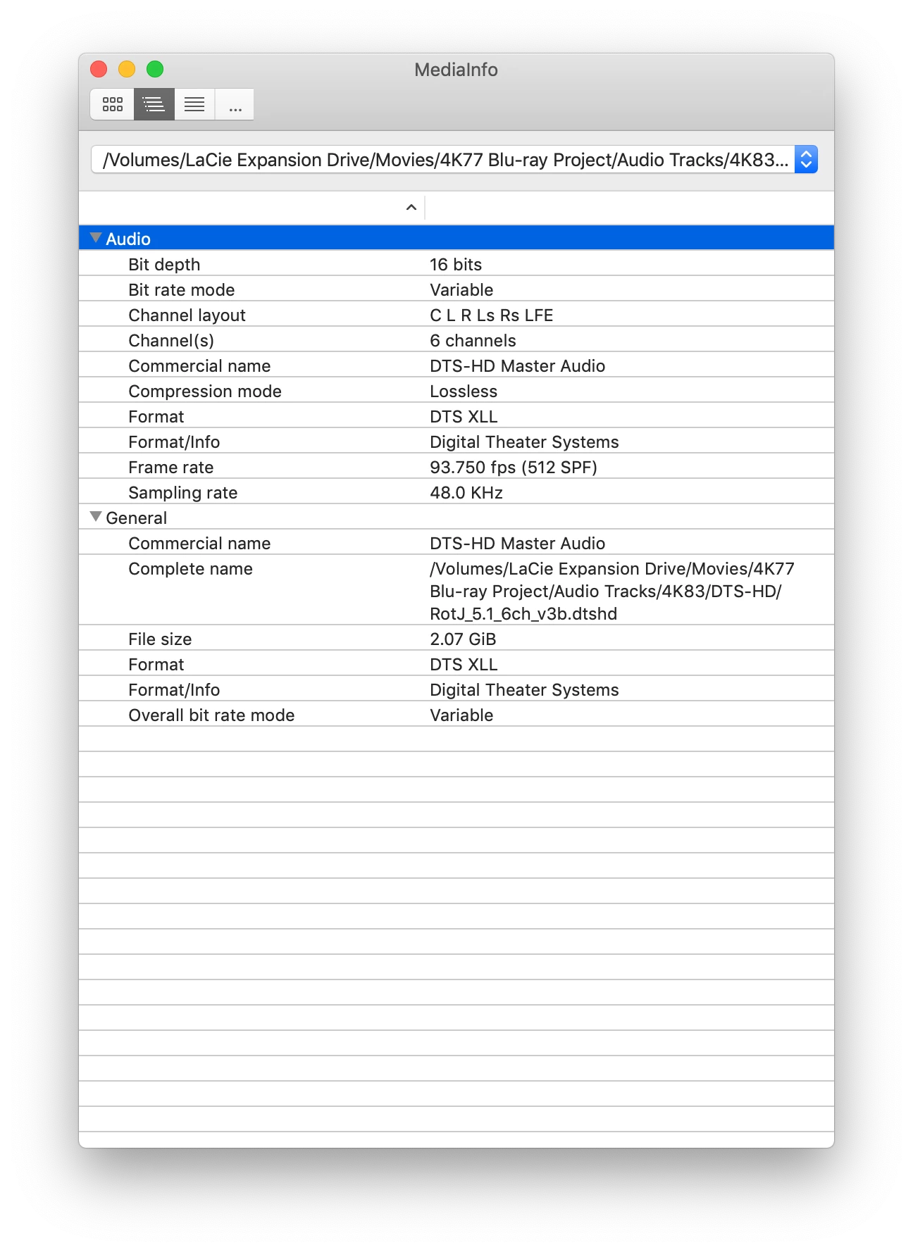

I'm trying to build a project in Encore with a couple of DTS-HD audio tracks (.dtshd), one of them is stereo and one is 5.1 surround. Each time the build fails with the error "Could not use file Stereo Audio.dtshd. This file is not legal for Blu-ray." When I delete the stereo track, the project builds, even with the DTS-HD 5.1 track. The only real difference between the two is that the stereo audio has a bit depth of 24 bits while the 5.1 track is only 16. Does Encore simply not recognize 24 bit DTS-HD audio, or is there something else I need to do to make it work?

Yeah, based on what he's saying there, there's no reason why this shouldn't be Blu-ray legal. Here are the MediaInfo breakdowns on the two tracks if that helps diagnose it.
This is the one I'm having problems with:
Meanwhile, this one works just fine:
Other than the fact that one is stereo and the other is surround, the only appreciable difference between the two is the bit depth, but according to the post you linked above, that shouldn't matter.

Can I ask what the running time is please? At 2Gb 16-bit stereo lossless it should be about 23 minutes, if my mental arithmetic is working (it may not be & I cannot find a calculator) - something looks wrong with the info file, so can I also ask how these were created & in what tool?
The problem definitely seems to be the 24-bit nature and it could be that there is no core stream - could it possibly not be a Blu-ray file but instead a high resolution media encoding instead?
