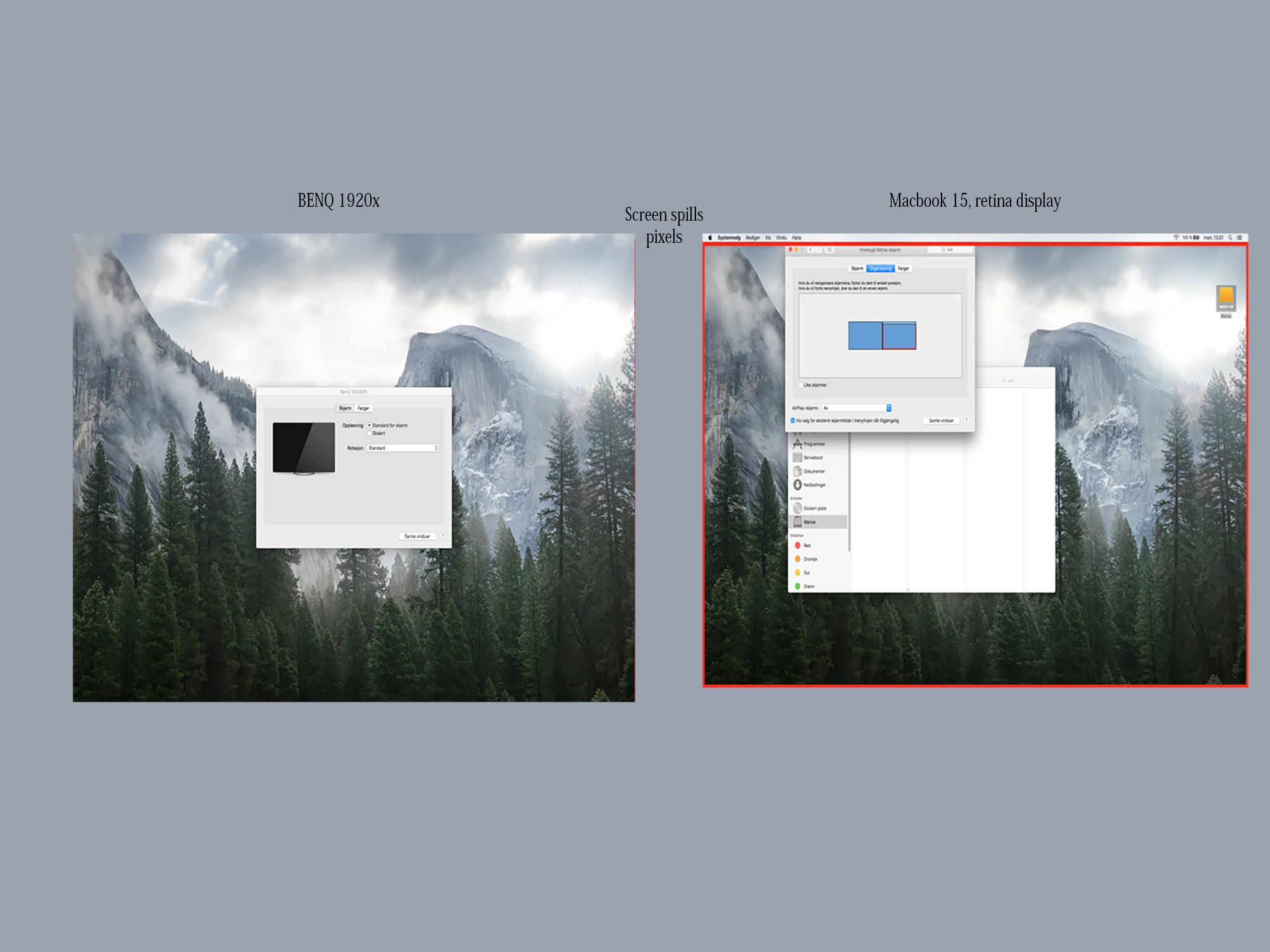

I´m currently busting my veins, SF Bay Video Creative. Maybe you can help me solve my issue? I have a Macbook 15inch Retina screen and a Benq secondary monitor. After I installed the new OS for mac El Capitan my screens started spilling into each other and I have no idea how to fix this. This makes it, like for the others, impossible to work with a full screen secondary monitor in several programs. Even when I toggle fullscreen on a web browser the other screen goes black.  How do I separate them??

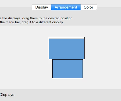

I had this same problem on my Macbook Pro running an external screen.
It turns out that if you have the screens arranged on top of each other, the out to the second monitor doesn't work - maybe because the dock and menu bars are on different screens.

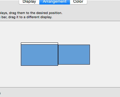

If I arrange the monitors next to each other it works fine.
The arrangement above doesn't work (even if the dock is on the left side of the upper monitor), but the arrangement below does....
This isn't really convenient for me, any my external monitor is above my laptop on so the up/down arrangement makes more sense for mousing... But at least it works.
Hope the helps someone.
