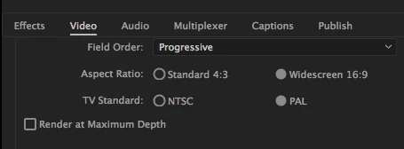

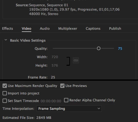

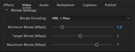

These are the screenshots of my export settings. The preset was PAL DV Wide Progressive if that helps at all
Thanks

When you take the screenshot, keep the top section where it has the source info (you have that in the shot) and the export summary (you don't have that).
I see your PR sequence settings. Wht is you source video characteristics? Is it 1920x1080 29.97 Progressive?
Converting to PAL like this is not a good idea. I don't recall if it ever works or not, but it often does not.
But the first things to check are:
Your minimum and maximum bitrates are too low. And a bitrate calculator says you can push your average up to 8 or more. So to simplify, export at CBR 8 for now.
On the left side of your export screen, set the cropping to "scale to fill." I don't recall PAL for sure, but think you need this to avoid thin lines on the left and right.
Do you have hardware rendering (CUDA) or not? If no, then use MRQ. If yes, do not select it.
Do NOT "use previews." You want PR/AME to create a new export, not use the previous previews.
IMPORTANT: when you import to encore, what does is say for the m2v in the Project Panel under the "DVD Transcode Status Column." If it is not "Do Not Transcode" then you have a problem.
