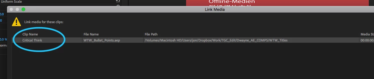

what I was suggesting is that you find the first iteration of the ae comp in your timeline.  control click on it and choose "unlink" then select it again and choose "link" and if you look at the clip name in the link dialog I think it's giving you the text that you've used for this specific iteration of the ae comp.  That should allow you to open the ae project, change the text and then render just this clip out and replace the problematic clip in the premier timeline.  Make sense?  see attached screen shot of the link media dialog.  If that works, you'ld have to do this for all the problematic clips, but should be doable

That gives me the clip name, which is a start for trying to figure out how to redo this, but it doesn't give me the actual text that I used.

So if you select the clip in the premiere timeline and control click and choose make offline and then select it and go control click again choose link media, you'll get the link media dialog which will give you the clip name which I'm assuming is the specific text which you can then reference to customize the "template" in aftereffects and then save it as an inidividual ae project or render it out and replace it in the timeline.  Make any sense at all?  Certainly is a little clunky but might be a workaround.
