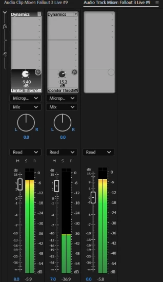

ive recently noticed when using the dynamics limiter or hard limiter it doesnt do anything anymore. it worked a couple weeks ago but now doesnt. I usually have my voice limited to-9.40, but it still goes way past -3 and peaks. i have made sure the limiter is enabled. Ive released 2 projects with this setting not working before i noticed which is frustrating.
i started using the dynamics limiter as the hard limiter option stopped working for me many years ago.
has anyone else had this issue or know how to fix it?

Hi @default54w22gptk8xk -  I received your project, thanks for sharing! Your limiter settings look correct, but it seems that increasing the track volume is overriding the limiter.  Could you try setting the track volume back to zero and let us know if that resolves the issue?  It's the blue number right above the A1 in your track mixer panel.
