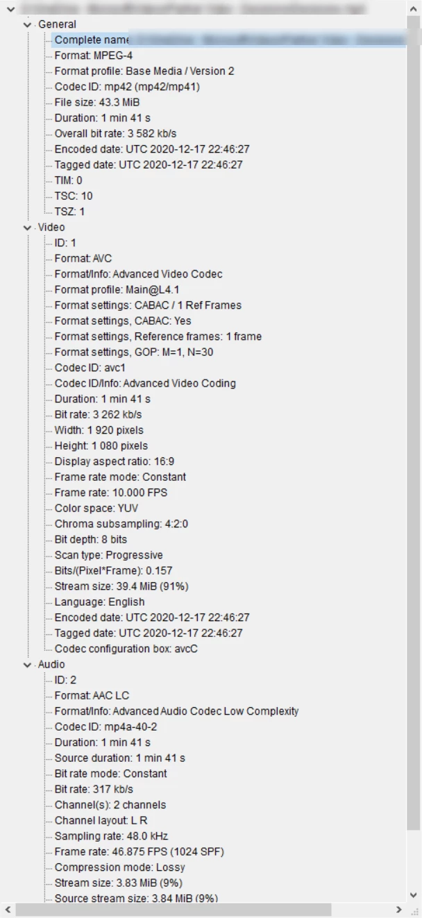

Mediainfo shows the framerate as 10. I would also look at that. Is that the source footage property or the sequence you placed it in?
Stan
December 18, 2020
Yes the Mediainfo shows the original recording downloaded from Microsoft Stream which is where Microsoft Teams saves the recording.

Please use the free MediaInfo and post a screenshot the properties of your media in tree view:
