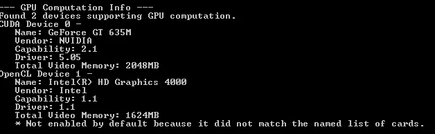

    I used this Hack but it did not work. What happened with executing GPUSniffer is it found my GTX 660 Ti and placed the entry into the cuda_supported-cards txt file but didn't leave a space between 660 and the Ti characters. I finally changed permissions and inserted a space at that point "GeForce GTX 660 Ti" saved it. When I reselected the Project Settings in PR it showed the GPU acceleration setting.
    Steven L. Gotz
    Dec 3, 2013 2:39 PM UTC
    Like I said. It is easier to just delete the file.

    I added the Geforce to the list, would I also want to put the Intel? This is for Premiere Pro CC. Also is this something that I would want to do if I wanted to increase the performance of SpeedGrade?
    Steven L. Gotz
    Sep 5, 2013 12:58 PM UTC
    Since the time that this thread was created last year, we have learned that it is easier to just delete the file rather than modify it. If the file is not there, the effects are not restricted to the cards listed in the file.

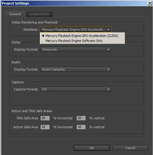

    I have added in my GPU and done all you have said...how do i know Premier Pro is using CUDA?
    Thanks
    Sep 10, 2012 3:18 AM UTC
    I am not really sure and on the road not near that machine. Maybe someone else can tell, it has been a while and I need to see it to recall where the indicator is. I think you could also tell by the encoding speed if you had a file to compare
    Steven L. Gotz
    Sep 10, 2012 3:43 AM UTC
    No problem. I am on my editing PC.
    The Project Settings dialog should look like this:
    If you don't have the CUDA choice, then you either don't have the right kind of card or you didn't hack the file properly.
    By the way, I have the GTX670 which requires the hack, even though Adobe tested the GTX680.
