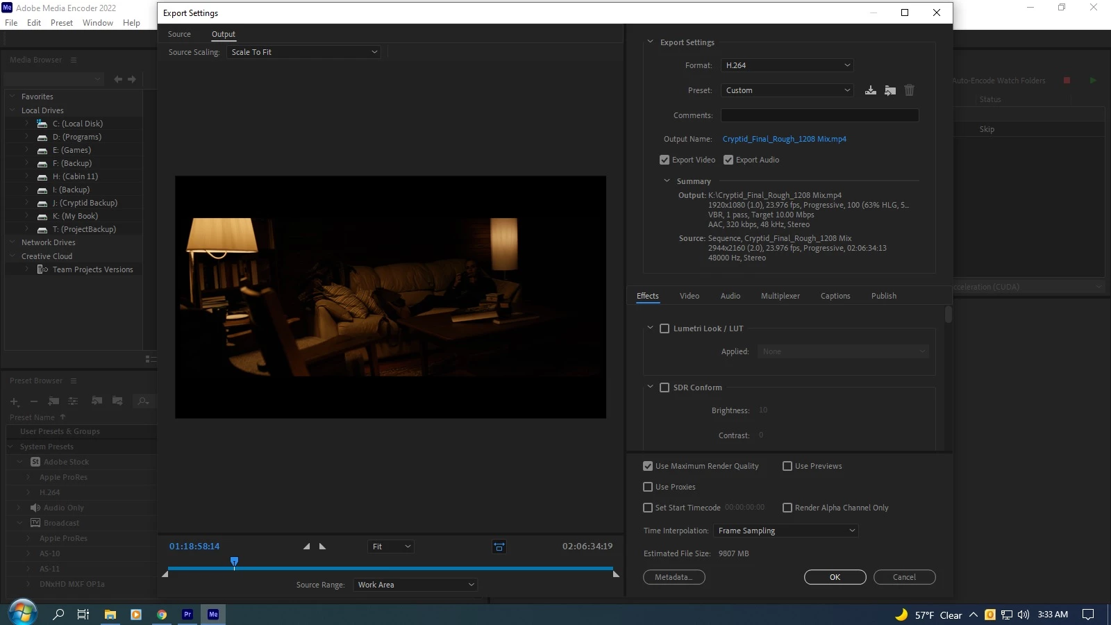

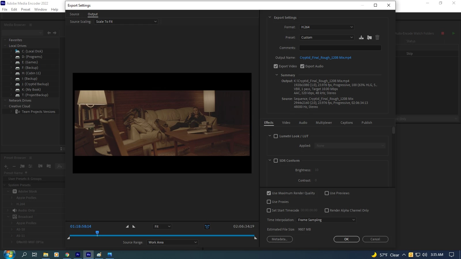

Have a project in Premiere 22.1.1 with footage from an Alexa Mini: ProRes 4444 2.8K 4:3.
When enabling Hardware Encoding it changes the color, saturation, and contrast. Its crushes the blacks and jacks up the contrast. If I set it to Software enbcoding, it looks flat, like its supposed to.
As an example, I sent the timeline to Media encoder for a .264 export, in the images I attached, one is where in Media Encoder I select GPU Hardware Acceleration, and the other is Software Only. Nothing else has been changed, and yet you can see its two totally different color outputs.  If I export with each I get a video that looks the same as the preview window.
This also happens if I set the Renderer in the Project Preferences to Hardware Encoding. The timeline shows the same color problem.
What am I missing? I have an NVidia GPU and its set to 0-255 Full color.
