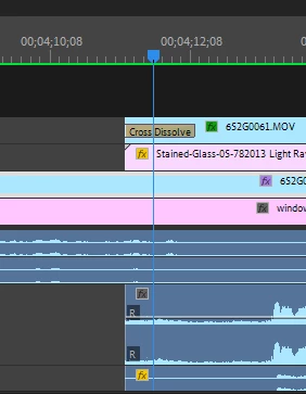

At 4 min and 12 seconds I have the dissolve on V4 starting with:
V4- BCC Primate Studio, Lumentri Color
V3- is just Mpg 4 (I encoded out from video with speed reduction of 30%, was choppy)
V2-Quick time video with Alpha rendered out of After Effects
V1- Jpeg plate

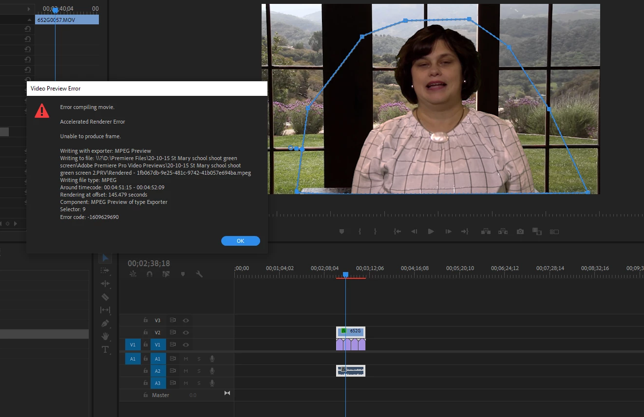

I can not render past this spot, when I did manage a QuickTime encoding I still got a flickering dissolve transition. Any idea why Adobe Encoder is failing?

Adobe Media Encoder ERROR
- Encoding Time: 00:00:30
10/30/2020 12:03:41 PM : Encoding Failed
Export Error
Error compiling movie.
GPU Render Error
Unable to process frame.
Writing with exporter: H.264
Writing to file: \\?\H:\Test Green Sceen 1.mp4
Writing file type: H264
Around timecode: 00;08;16;18 - 00;08;17;20
Rendering effect: AE.ADBE Opacity
Rendering at offset: 252.085 seconds
Component: EffectFilter of type GPUVideoFilter
Selector: 9
Error code: -1609629695

More testing taking off the dissolve worked once but not again. I created a new timeline and put the clips on it again and when I added a mask to Primatte that's when I got the render error. Mask was added to Opacity.

Answer: Adobe phone support dumped my cache and that seemed to have worked. She also turned off GPU in project but I don't think that was what the problem was.
