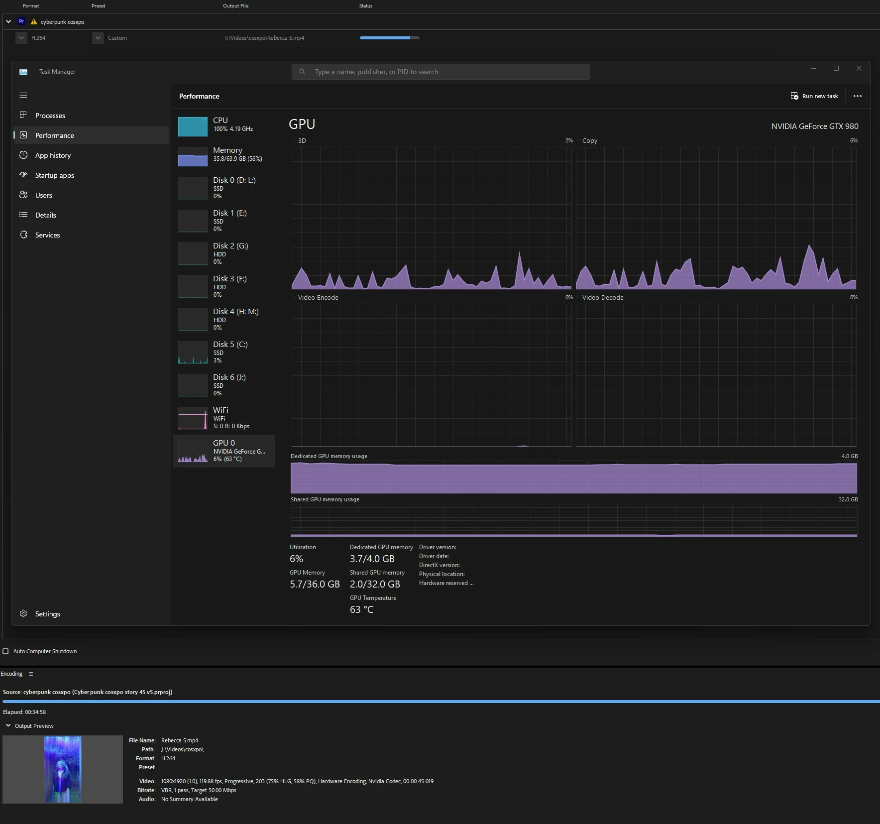

Hi all, I've looked into my slow encoding performance a lot. Everything I've read so far would have me believe my system is working normally. But I'd love to get some clarity.
I've made sure all setting relating to hardware encoding are on, that my GPU can encode h.264 / h.265.
I know I get fairly good use out of my GPU in the timeline, I can scrub full 1080/120 footage smoothly. Even 4k footage is fine.
So my question is when I'm exporting and the engine is set to CUDA, how come I see virtually no GPU usage? (only copy gets used) While my CPU will handle the whole process. Feels like software rendering?
While my GPU is old now, it's still on the supported list and is capable of encoding and decoding h.264/5
I'd quite like to upgrade it, but also if this kind of behaviour in exporting is just the way it is then there is no point in considering a new GPU.
So in short, I think this is normal, but I'd like a second opinion please!

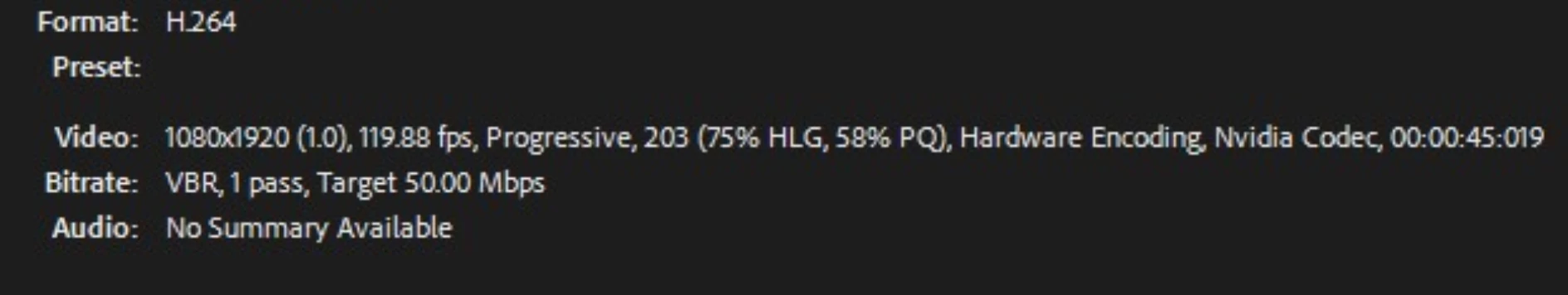

Hi @Summit22069854j5jq
Unfortunately nvidia no longer supply studio driver for the gtx980, so I'm fully up to date on the game ready driver instead
 you can see the summary of the export settings in the attached image
April 19, 2023
Hello, my change the sequence settings to 24fps, currently it is 119fps.

Yes, it looks like your CPU is maxed out. The GPU is still currently not entirely used in PP. Just on specific things. GPU accelerated effects and changes to frame size. You can find a document on that.

Yes, its an AMD 5900x, I won't have anything faster for a long time yet!
I don't suppose you can use a GPU dependent effect across the whole video to get encoding to run quicker. If I was to raise or lower my output resolution from source for example?
In guessing the cpu would render the frame and then the gpu would resize it?
Just wondering if there are any odd tricks to speed things along a bit.
