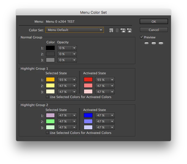

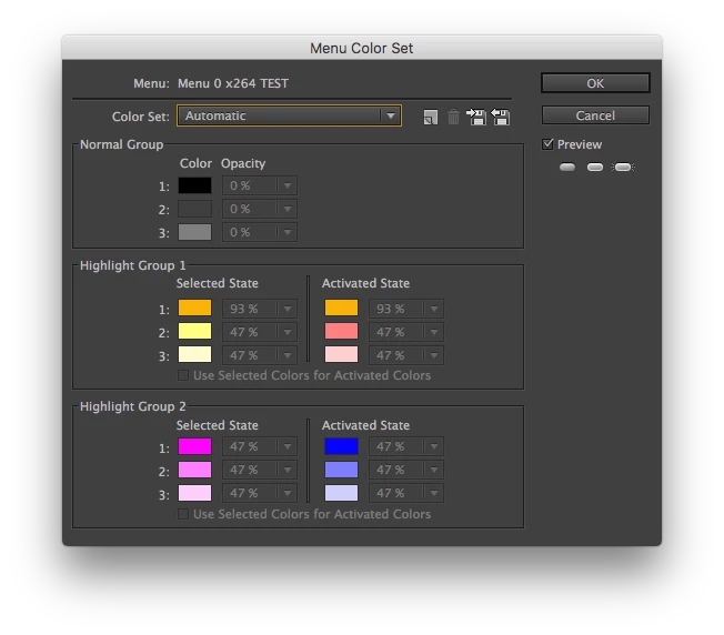

In the DVD Project I create a custom "menu color set", I did the same in the Blu-Ray project. I discovered, when I leave the menu color set on "automatic" it works, the highlights are visible. Anything else ad they are not visible after I built the project... So how can I trouble shoot this? How can I fix this?

I then experimented with the opacity of the menu color set colors.
When set on automatic the highlight colors have a 93% opacity.
But the customisable sets also have a 93% opacity and the end result has invisible highlights / doesn't show the highlights at all.
BUT!
BUT when I change the opacity from the default 93% to 100% it will be visible. So that is my fix for now. It doesnt matter what group or if (=1), (=2) or (=3), no difference. I have to set the opacity of all colors to 100% and then it works fine...
Highly confusing as the automatic color set also has it's opacity on 93% but here it works fine after exported...

Please post a screenshot of your menu color set when not automatic. That is the likely culprit. Compare them to the DVD version; any changes? Here's help for color sets:

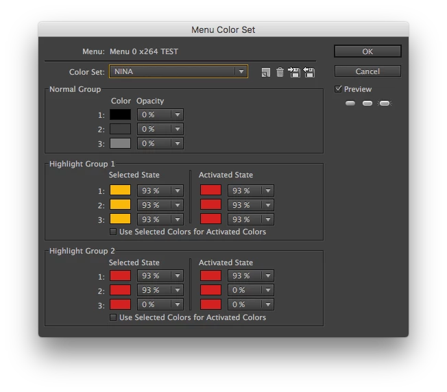

I first imported the Menu color Set from the DVD Project "NINA", since it uses the same colors and styles.
I used this and the highlights were invisible once I exported the project (ISO or Disc), but they're fine in the preview inside Encore.
I then used "Automatic" and tested it with that, the highlights are visible even after creating an ISO or Disc.
But I want to customise it so I then tried "Menu Default" and exported it again. Again, highlights are not visible... So whenever I use a user customisable Menu Color Set it seems to not show the highlights in the end...
I'm experimenting with the "Menu Default" now and change it a bit and try what effects it might have ...
