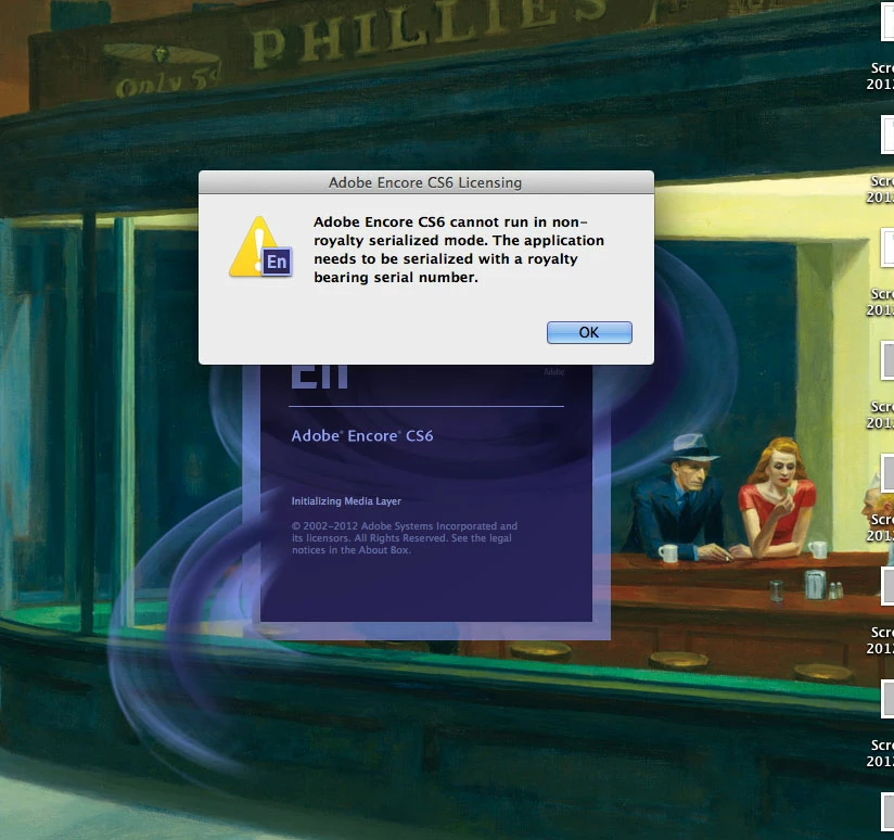

When I open Encore for the first time everything works great. Once I close it and try to open it again I get an error message that says:
"Adobe Encore CS6 cannot run in non-royalty serialized mode. The application needs to be serialized with a royalty bearing serial number".
After this, another window opens asking me to input a serial number. As I am a Creative Cloud subscriber I do not have a serial number to input here. Adobe does not provide one for Creative Cloud users.
(I've included screenshots of these messages below).

Originally I downloaded and tried to run Encore as a trial. Later I decided to subscribe via Creative Cloud. I deleted Encore and Premiere from my mac (but didn't use the 'uninstall' option, because I didn't know that existed, I just deleted all the files). I then downloaded Premiere again following the Creative Cloud directions. I'm guessing there might be some kind of hidden file or key which is telling Encore not to run without a serial. How to remove this file/key or even if this is the issue I have no idea.

Hi jaypurcell,
I think you are facing this issue because you did not uninstall the earlier version cleanly. First uninstall your current version and then try to clean your machine to remove any traces of previous installation using the cleanup scripts posted by Adobe here- http://helpx.adobe.com/creative-suite/kb/cs5-cleaner-tool-installation-problems.html
and then install Encore afresh.

Thanks everyone for your useful info.
I haven't had a chance to resolve yet. I will post here once I have tried a couple of things.
shuchi, yes I think you may be right about the uninstall not being done cleanly.
I'll give that tool a whirl.
