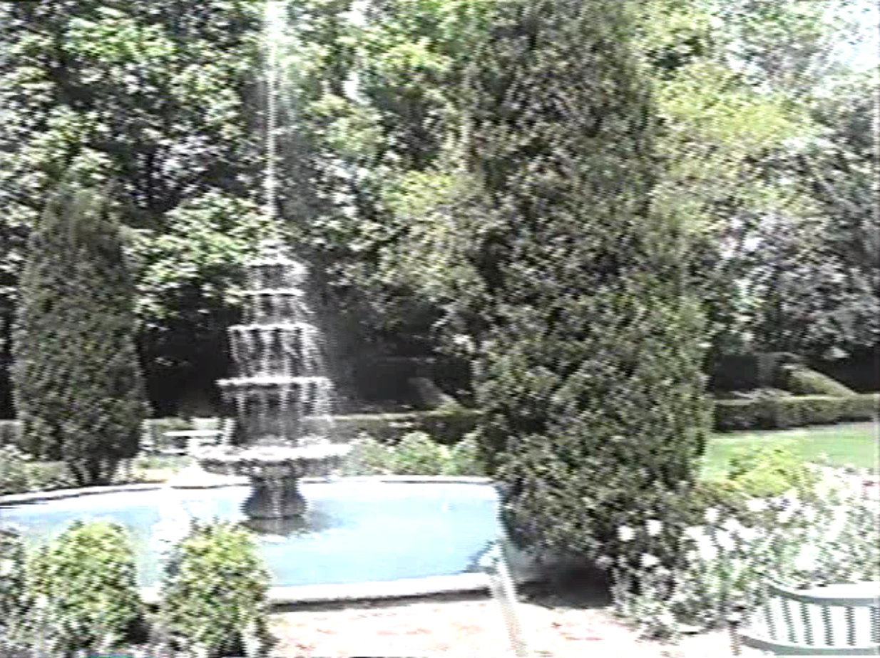

So it will my first Premiere project can you suggest where can I find good and detail tutorials to perform my project in Premiere CC?
The screenshot of video:

That's very low resolution.  I would be surprised if you could improve it much.

The video by itself not to bad but because it digitized from VHS it is not sharp. It looks like video of beginning 90's. I would like to modify it to good modern video if it possible.

Perhaps give an idea on what problems that you are seeing. Perhaps a screen shot.
