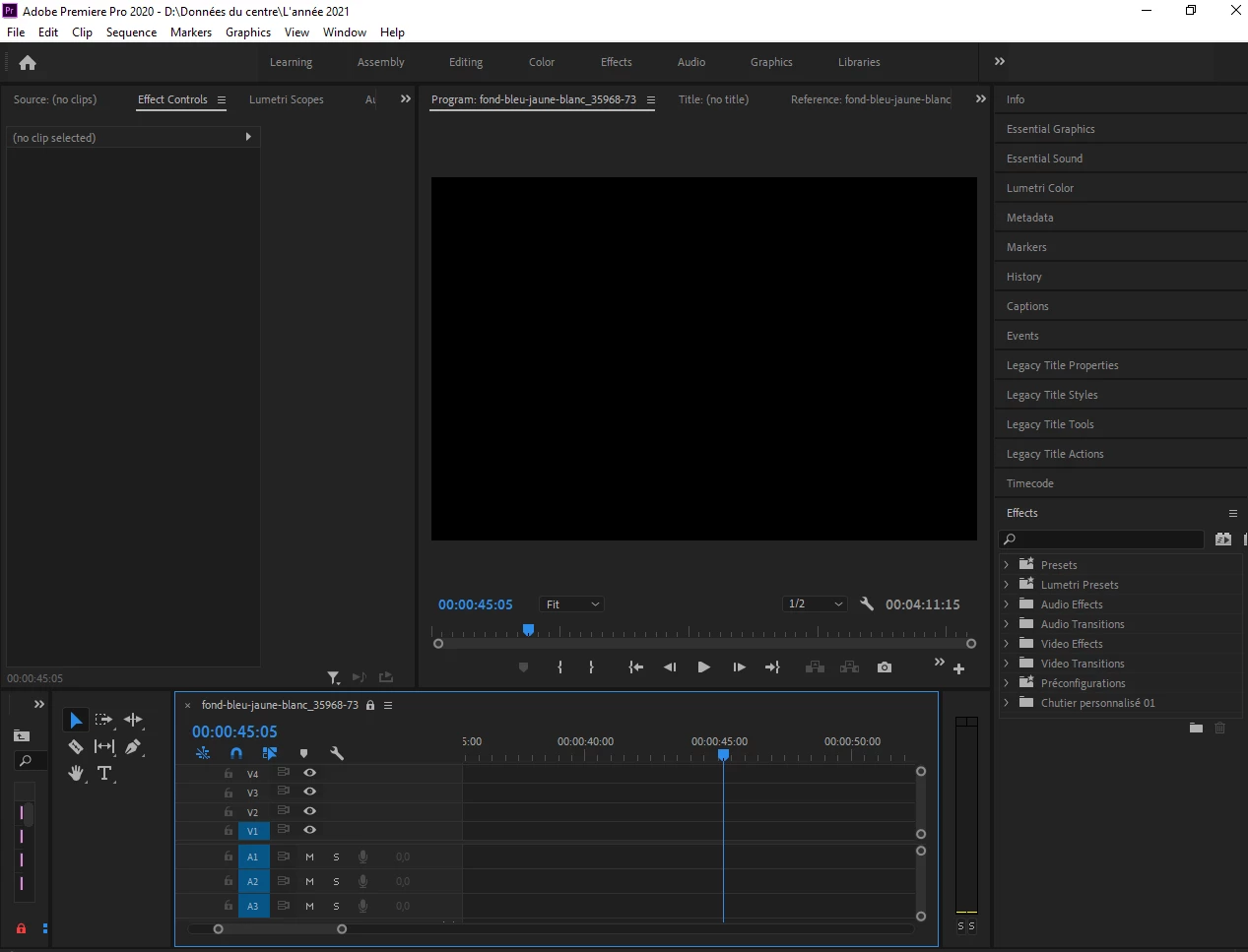

I'm using Premiere pro at work, and im the only one. It's been 2 weeks that the project is locked by a red padlock even though it's not a shared project...

Your project is, I think, in read-only mode. What happens if you click on the lock?

I don't know if that answer what you said, but this message appears when i click on the padlock...
I've searched everywhere and I still don't know what's going on, hope this image helps too!

Hi haise5E13!
Sorry to hear that. Can you provide more details on what's going on? Could you share a screenshot of the issue?

So this message appears when i click on the padlock. The only thing is that as I said this is not a shared project as I'm the only one on it. More than that, is that "eel" is the computer name...
