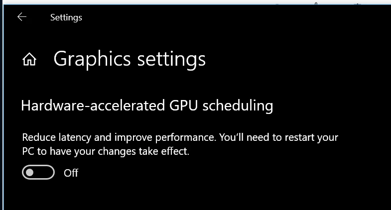

There is also one other setting you can try related to video performance buried in windows 10 thats a new thing.  Windows at some point last fall, added Hardware GPU Schedule in the Settings for Graphics cards (Display Settings, then graphics settings).  The screen shot is below for the menu.  This by default is OFF.  But try turnign it on (on a very small set of apps will run slow with it on, youtube has some benchmarks if you want to know more on this).  One pro tip here, is the note that says you have to restart windows really means restart windows, it doesnt work with a power off then on as it keeps the setting until a true restart is issued. Use the restart in the shut down window.  Let me know your thoughts, I hope there is something new here that can assist you.  Sorry about your troubles, they are very strange.

When you mentioned the GPU scheduling, I really thought that might be it-- I remembered I had to enable it because of some other software somewhat recently, but it doesn't look like that's the case.
